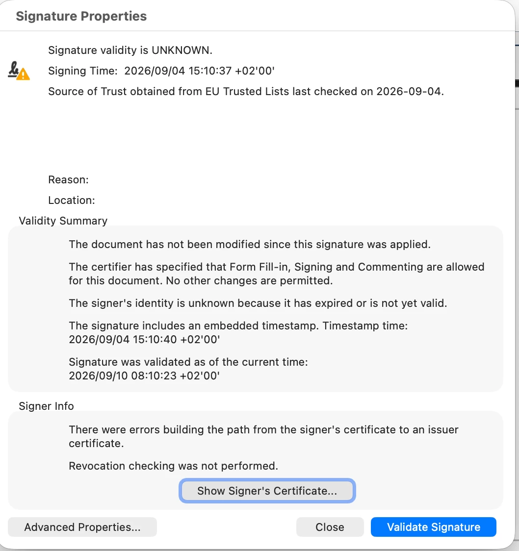

If a signing certificate has the extension `id-etsi-extension-validityAssured-ST-1` (defined in this etsi standard), adobe doesn’t honour the extension, but instead looks for LTV data for the signing certificate. Since none is present in the /DSS, Adobe states that the signers identity isn’t valid (because of expiration or not yet valid).
The proper behaviour should be that if the certificate has that extension, and its validity is within the signing time of the signature and covered by a time stamp, Adobe should validate the identity as  trusted.
I’m aware that I can change the preferences for Signature validation to ignore document validation information, but this is a very blunt way to solve this. IMHO the validation should be able to make this distinction automatically.

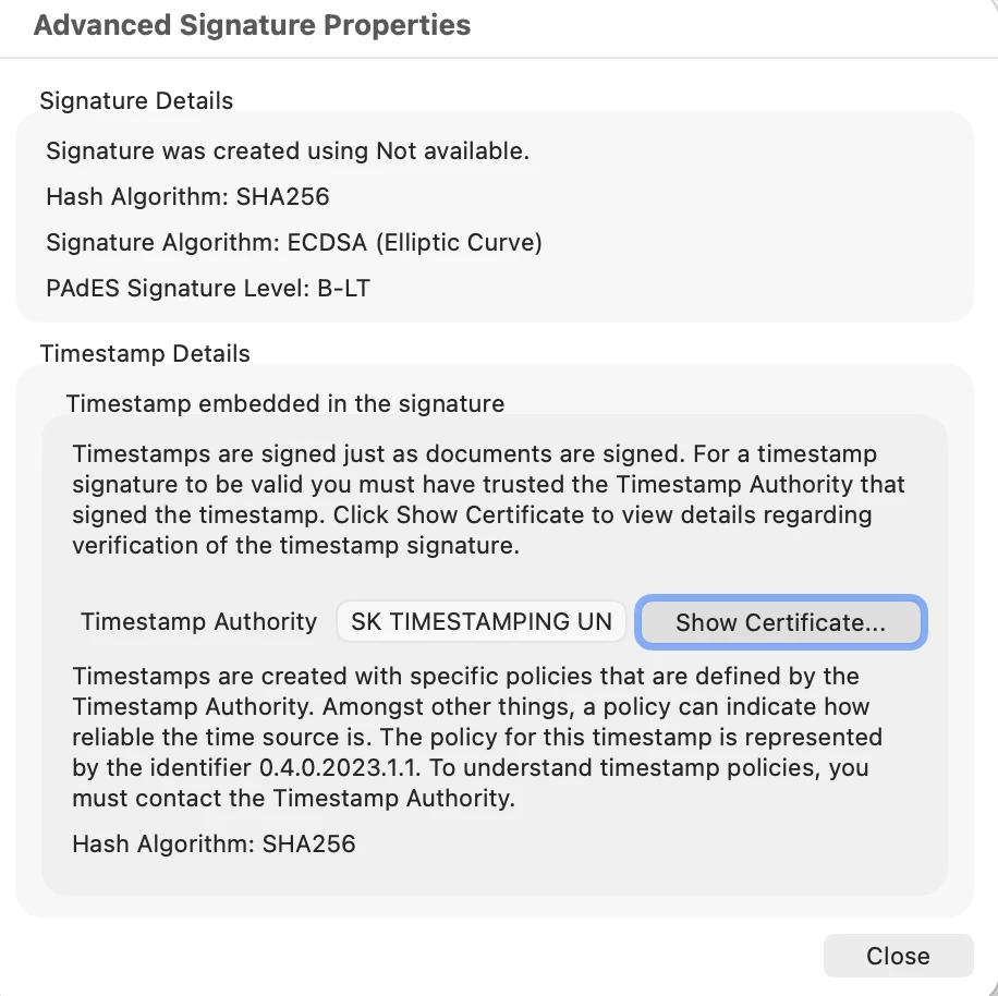

    The Signature is of the PAdES -B-LT level, QES and the certificate chain leads to an EUTL trust anchor.

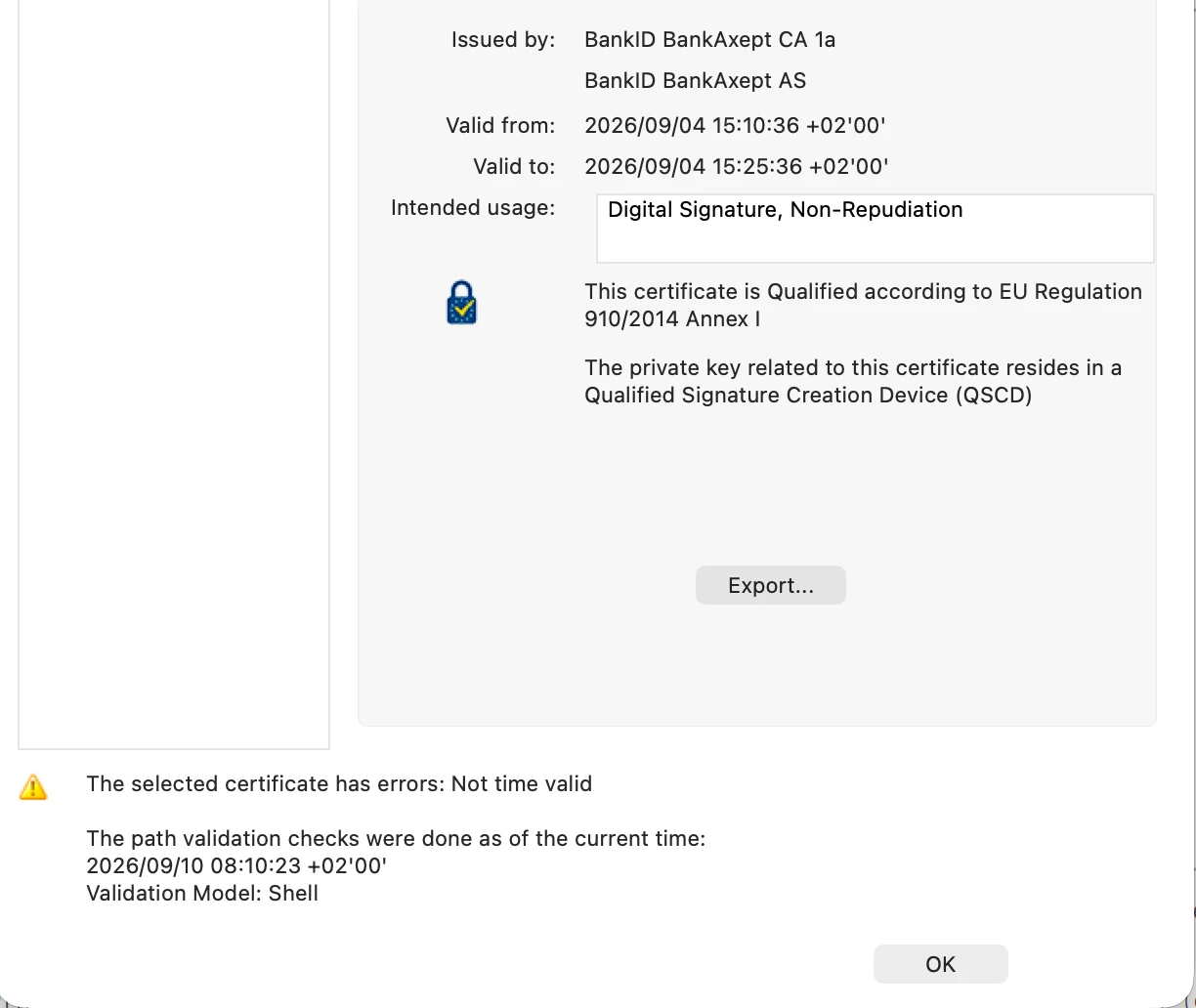

    And here’s a pic of the certificate details:
    And here’s a pic of the signature properties:
    Here’s a pic on the advance properties:

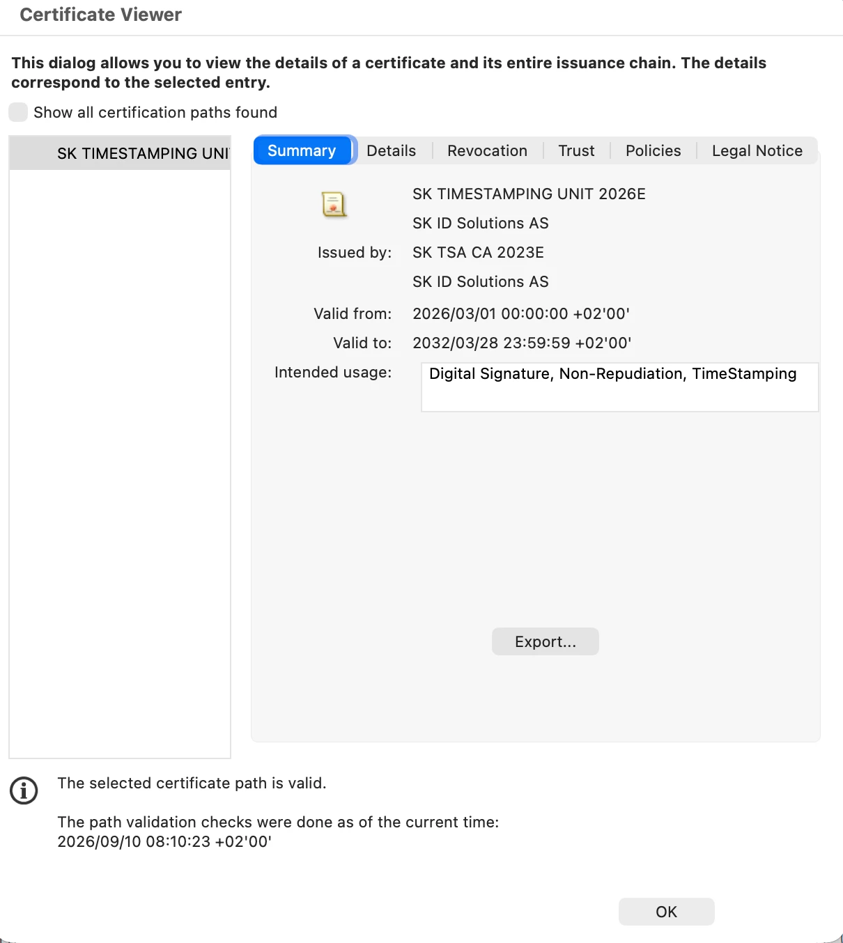

    And here’s a pic on the timestamp certificate:

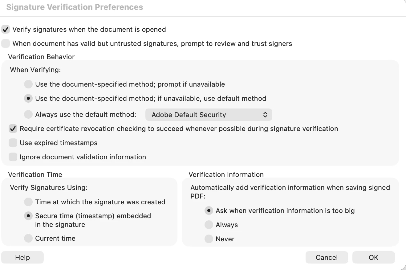

    My Signature Verification Preferences looks like this:
    It only validates with a green check mark if I have unticked the “Require certificate revocation checking to succeed whenever possible during signature verification” box. Irrelevant how I have the two following boxes ticked.
    Another  interesting note is that it seems like Adobe validates the signature at Current Time, even though in the preferences it states that it should do it at the Secure time (timestamp).
    Not just an interesting note, this is why Acrobat reports the verdict that the signer certificate is expired. The question is, what makes Acrobat select that validation time. If Acrobat is happy with your time stamp, validation time should be the time stamp time.
    When you uncheck that box, does the validation time switch to the time stamp time? And what happens if you select “Time at which the signature was created” instead of “Secure time (timestamp) embedded in the signature”?

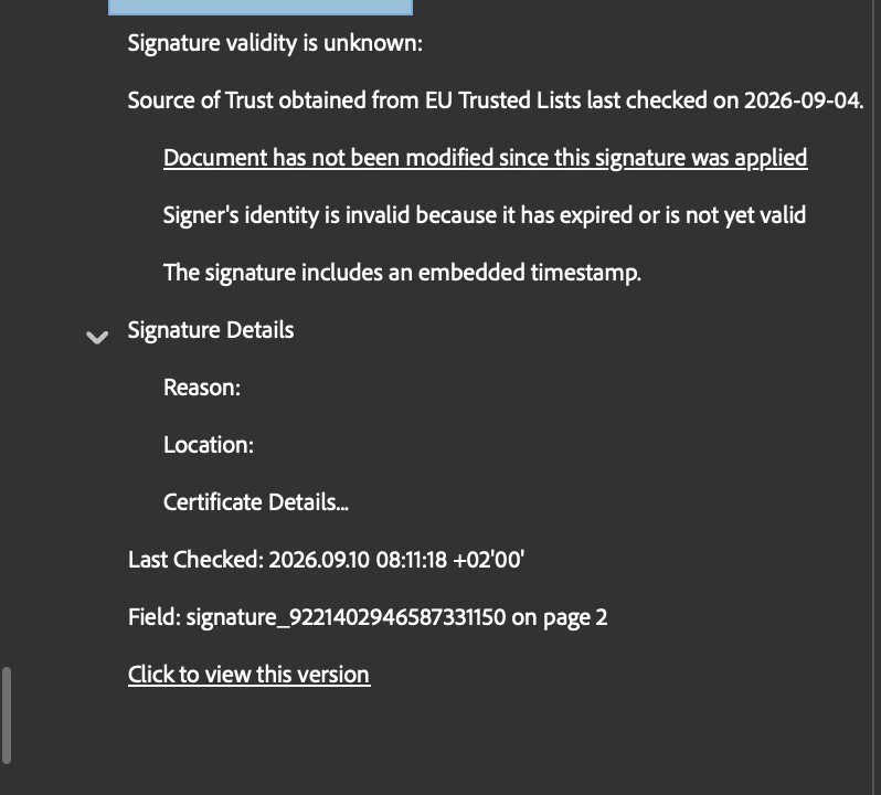

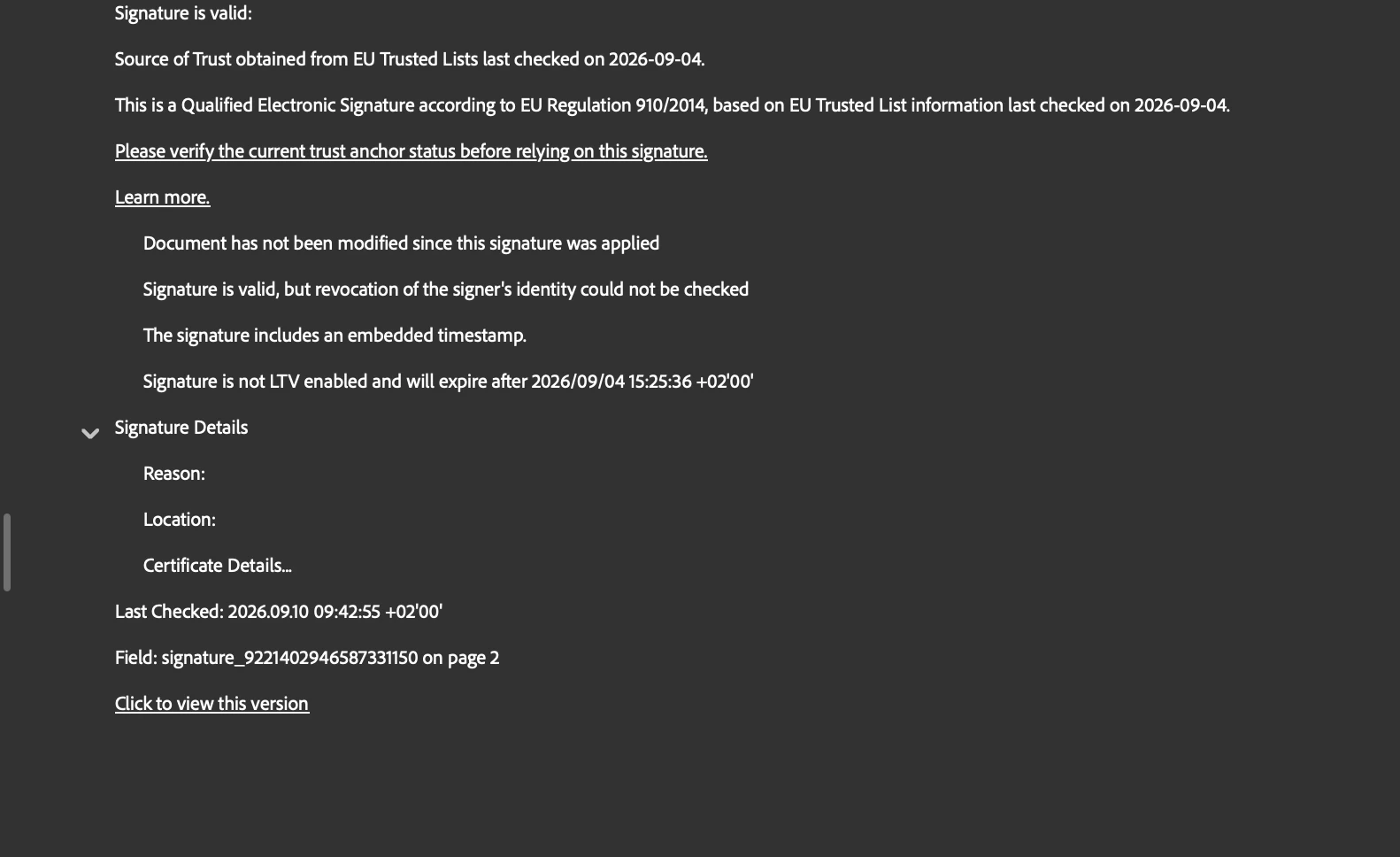

    When I uncheck that box, it validates against the timestamp time and it is valid

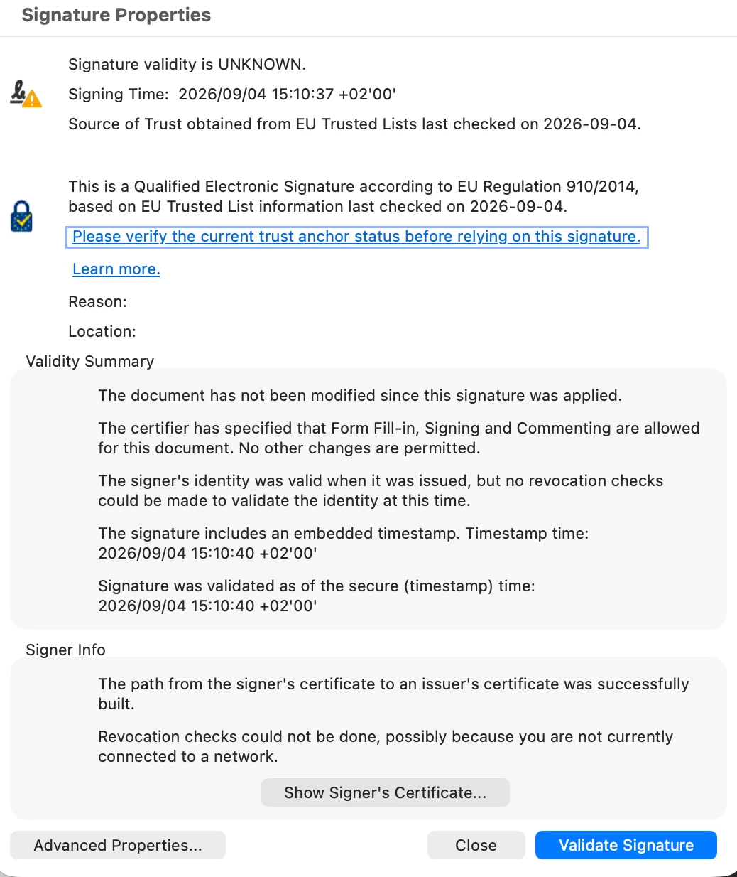

    When I select “Time at which the signature was created”, and have the above box ticked, it validates against the secure (timestamp) time, but it says that the validity is UNKNOWN,  see this pic:
    So the signature is only found to be Valid if the “Require certificate revocation checking to succeed whenever possible during signature verification” is unchecked , regardless which one of the top two verification time options that are chosen. (choosing Current time doesn’t validate obviously)
    And if that box is ticked, it never validates green.
    Hmmm, "because of expiration or not yet valid" does not sound like being related to Acrobat missing validation related information but more like the signing time is not in the (short) certificate lifetime.
