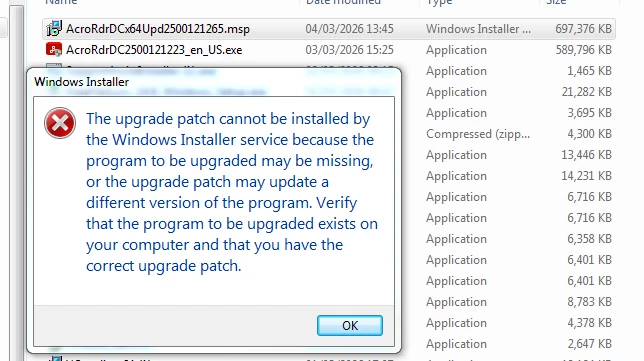

NickGama
Mar 4, 2026 1:51 PM UTC
Hello Meenakshi,
I have uninstalled the acrobat reader that was giving the error. Downloaded the 25.001.21265.
I am trying to install this but getting this message. Can you help?
Thanks, Nick Gama
