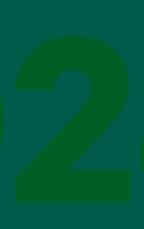

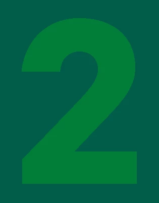

Hello!
We have a pdf File from a Customer which has an overprinted text which i assume the overprint view does not show it correctly.
The background color has the CMYK Value 100/50/80/15.
The text has the CMYK Value 0/12/100/0 and is overprinted with opm 1.
From my understanding the resulting CMYK Value for the overprinted Text should be 100/50/100/15 with opm1.
I have attached the PDF, a Screenshot of the resulting display in Acrobat and a Screenshot how i think it should look.
Am i wrong with this?

I know it sounds crazy that the preview could be wrong in both programs. But technically overprint comes from printing one color over another color. and more color in cmyk means means a darker print. The best explanation from OPM 1 that i found is from heidelberg: https://onlinehelp.prinect-lounge.com/Prinect_PDF_Toolbox/Version2021/de/Prinect/Color_management/Color_management-9.htm
And in this explanation my assumption would be right and it should look like the gmg example.

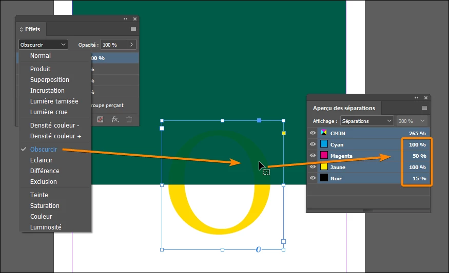

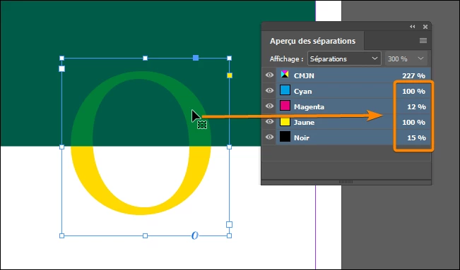

It doesn't look like an Acrobat issue.
When I use overprinting in InDesign, I get the same result as in your file (1st screenshot).
To obtain the values you want, you need to use the Darken* mode in Effects (2nd screenshot).
* I'm not sure about the translation because my InDesign is in French, but the items are in the same place.
November 23, 2023
Correct, in Indesign i got the same result. The question is what is the technically correct result. I got different result when i use different RIPs to print the page. For example if i let it process in a GMG Colorserver (which uses the Adobe PDF Print Engine in Version 6.1 i think) i got the same result as if you use "darken" effect in indesign. And i think the result from the processed file in GMG Colorserver is technically correct and the overprint preview in Acrobat is wrong.
