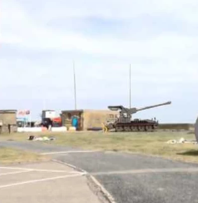

    Way to go (as we say over here).  Sounds like a lad with proper values, and I suspect he will go far.  I am wondering what the microphones are picking up though?  Are you using the time between sound of the release, and the sound of the soda can being hit?  Or how does this work?
    If you could drill a tiny hole through one of the projectiles and make it whistle, you could maybe work out the speed with Doppler?  That was how the Brit MOD measured artillery shell speed at Foulness — my last boss before I retired from Ford Research used to work there doing exactly that, and it was fascinating hearing about it.  Luckily he didn't have to kill me after telling us how it was done.
    At one time, they looked at building a third London airport off Foulness, but one of the problems was clearing the thousands of shells they'd fired out onto the MOD owned mudflats (Maplin Sands)
