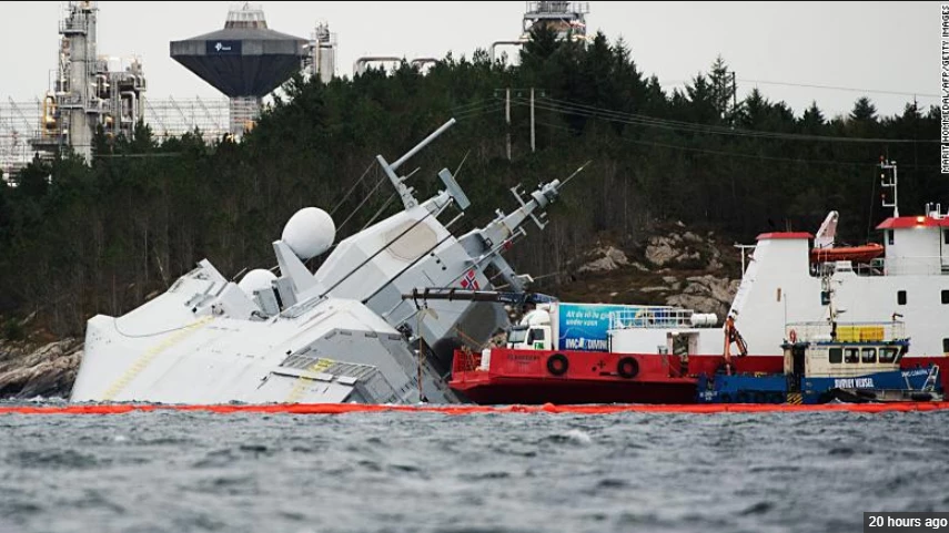

It started with a billion krone frigate coming off second best after colliding with an oil tanker in a Norwegian fjord resulting in a huge rent in the side of the frigate.  The oil tanker is completely undamaged, so  it might be time for the world's navies to rethink their buying strategies.

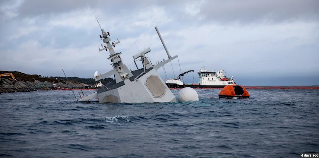

They moved the sinking frigate to the rocky shoreline to prevent it from sinking.   Then embarked on a rescue mission trying to pull it up enough to patch the holes, using best quality Norwegian steel cable...
...which broke  and things have gone from very bad, to much worse.  I love the wee red life-raft.  Apparently no other Norwegian warships would go close to the life-raft in case they collided with it, and sank (the worships... not the life-raft).

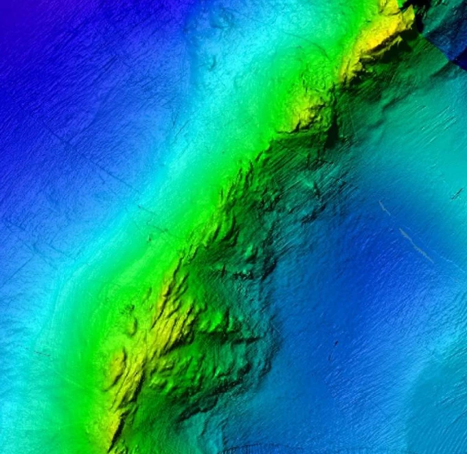

I've not seen pictures of the shoreline, but my mind picture for a Norwegian fjord  is of  steep mountains coming down to the waterline.  We have the same thing here with our Marlborough Sounds, and what we learn in is that the angle above the waterline tends to continue below it.  The Sounds get very deep, very quickly.  It could be that another 25 metres from the shoreline, would drop the frigate _well_ below the surface, and present an  even worse problem.
The exception being where the end of a ridge  meets the water — you cut those corners off at your peril!   Those ridges tend to be great fishing spots, and many a boat  has sat on top of one for hours, and suddenly realised that the tide has grounded them!

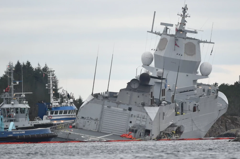

    In case anyone's still watching, the post-crash investigation have published their preliminary findings. They have had full access to classified material. This wasn't to assign guilt, but establish a detailed timeline and record of what actually happened.
    They emphasize that no one single action or event caused the incident. It was a long chain of circumstances, decisions and actions that led up to the crash. But among the more spectacular contributing factors are these two:
    • The oil tanker left the terminal with full on-deck floodlighting, which they're not supposed to, and it still appeared to Helge Ingstad as part of an on-shore installation. It was lit up like a small city. In short, they saw it the whole time, but mistook its identity in that critical time-window.
    • The water-tight compartments of Helge Ingstad weren't water-tight after all. This was a flaw in the construction, and the Spanish shipyard may be in trouble. If this had been according to spec, the ship wouldn't have sunk, or at least not nearly as fast.
