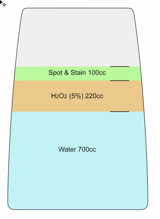

Before I started this thread, and was playing with this in my head, I just wasn't getting anywhere, but after making the graphic below (specifically for this thread) and measuring the liquid content to each of the three level marks, I think I have worked it out, but I might as well run it by some of you young folk with still function brains.
The graphic represents the reservoir from my Bex Bissell carpet stain cleaning machine.  The chemicals are fairly costly, but it is known that what they call the Oxidising Boost agent, is 5% dilution of Hydrogen Peroxide, and you can get it for a tiny fraction of the cost from the likes of eBay.  Except they only provide it in 3% dilution.  So I need to work out where to put the new mark.
It uses 220cc of the H2O2, which I worked out to be 11cc of pure H2O2.
Together with the 700cc of water, that's 11cc in 920cc , and I need to achieve that with my 3% dilution H2O2.
I think it is actually really straight forward, but I would like to hear if I am getting this wrong.
If 100cc of the 3% solution contains 3cc of pure H2O2, then I need 11 / 3 = 367cc of the 3% solution.
So I just need to subtract 367 from 920 = 553cc and make a new mark for the water level.
Add 3% solution to the original 2nd mark, and then add the 100cc of the Spot & Stain chemical as normal.

    Maths looks right to me Trevor .
    553cc Water ;  367cc 3% H2O2 and 100cc Spot & Stain
    Dave
    Trevor.Dennis
    Aug 24, 2017 10:01 AM UTC
    Thanks Dave.  I doubt that it is in any way critical to get it exactly right, but we are slaves to our geeky natures.
