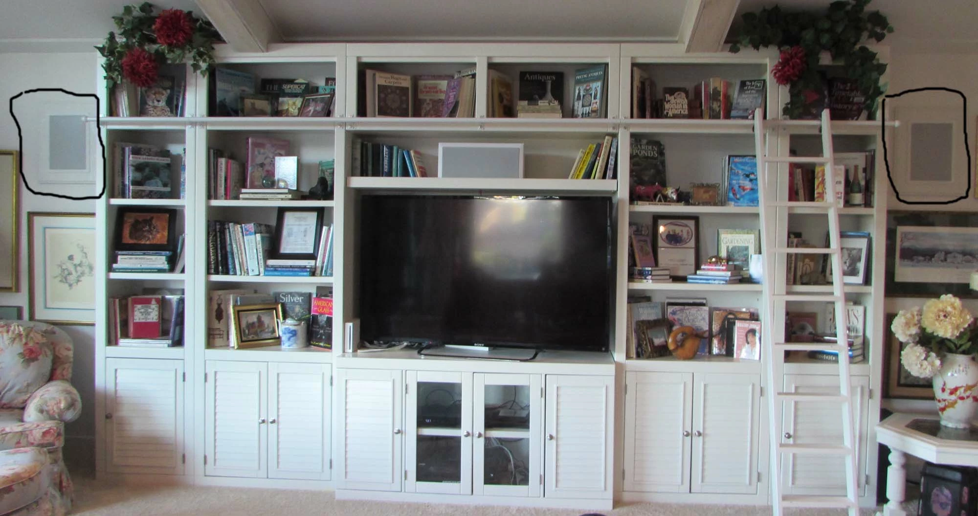

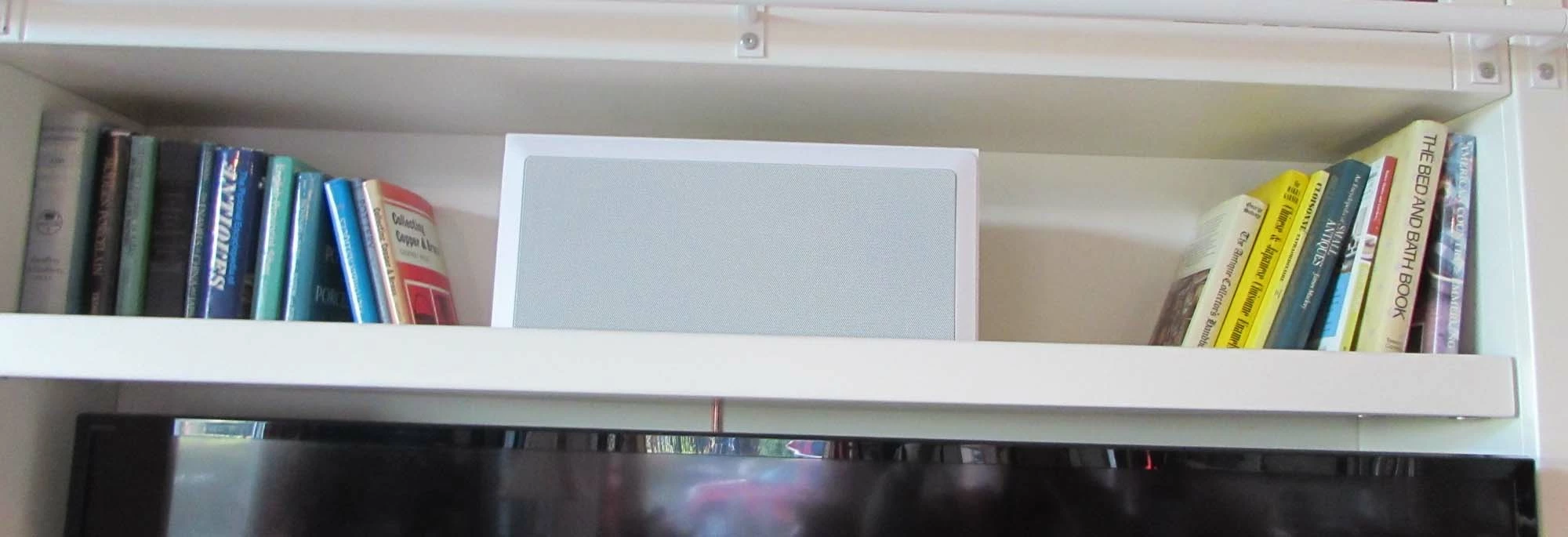

Added... the reason why I was checking sound settings was I added a center channel speaker
When we bought & remodeled our house my wife put a library & TV cabinet on the living room wall... I installed a pair of in-wall speakers on either side of the cabinet, but she would not let me cut a hole in the back of the cabinet for a center speaker AND she said no to a black speaker to sit on the shelf... so I just didn't add one for awhile, since the only white center speaker to sit on a shelf that I could find was a very poorly rated one in a plastic housing... when I finally decided to proceed I bought a wall mount speaker and built my own box out of some 1x6 left from another project... now have much richer sound and she even approves of the white speaker box that sits on the shelf above the TV
