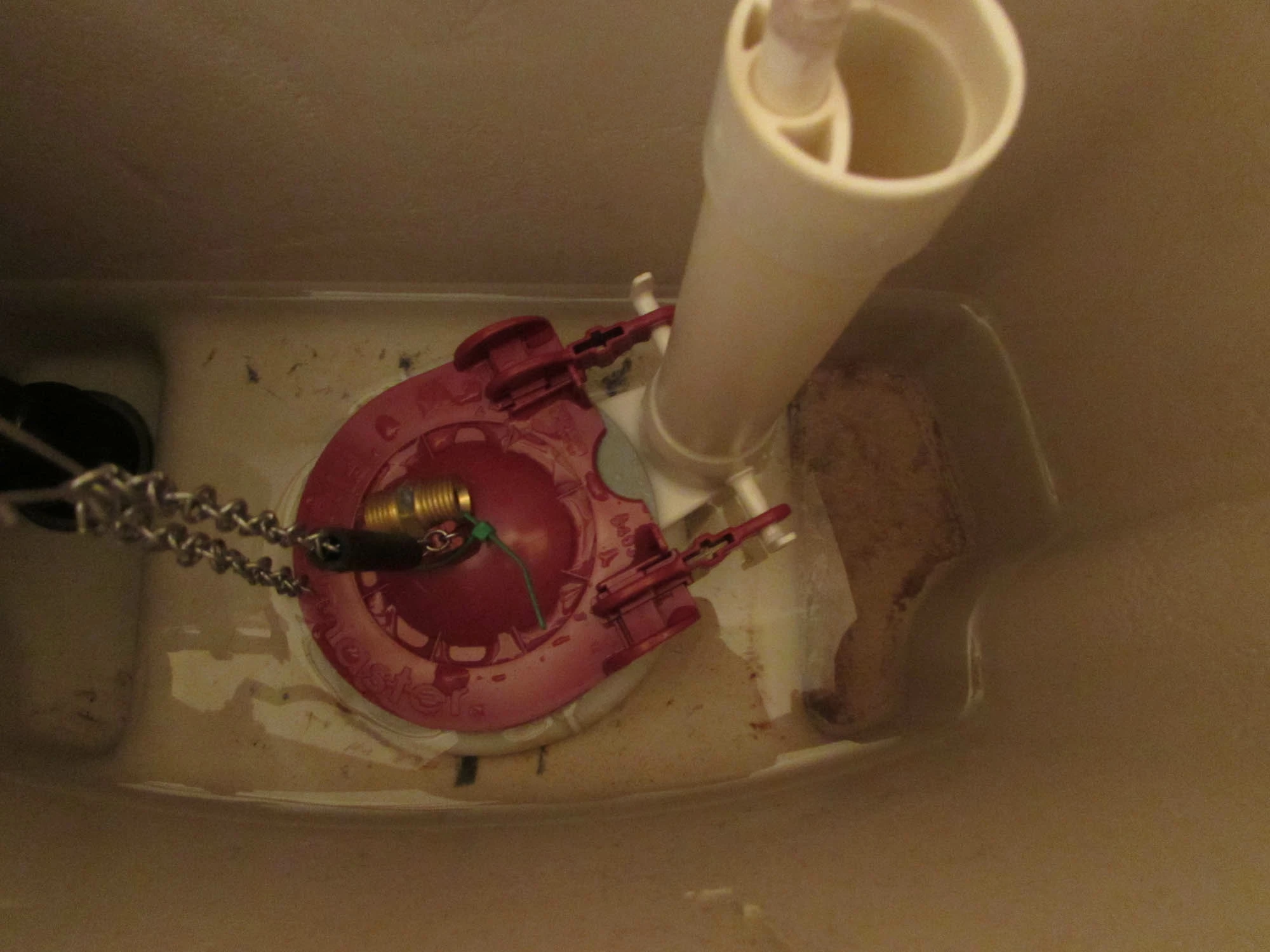

    Vancouver water has a high mineral content (spots left on shower walls) and our toilet kept dropping an inch in the tank and running to fill the water again... put a new flapper in, with a silicone ring, and it didn't fix the problem
    I called Grover plumbing and the advisor said to use wool from a mechanical sheep to gently rub the flapper ring to get all mineral build up off of the ring
    When I put the flapper back on I added a small (brass to not corrode) weight on top of the flapper to make sure it is held down against the ring... still flushes (not much weight) so now we wait and find out if that fixed the problem, or if I need to find out how to replace the entire flapper assembly

    You could also use some white vinegar to dissolve the minerals. Let the flapper soak for a bit. It does a treat to boil some water and vinegar in an electric kettle! (Where I live, the water is hard.)
