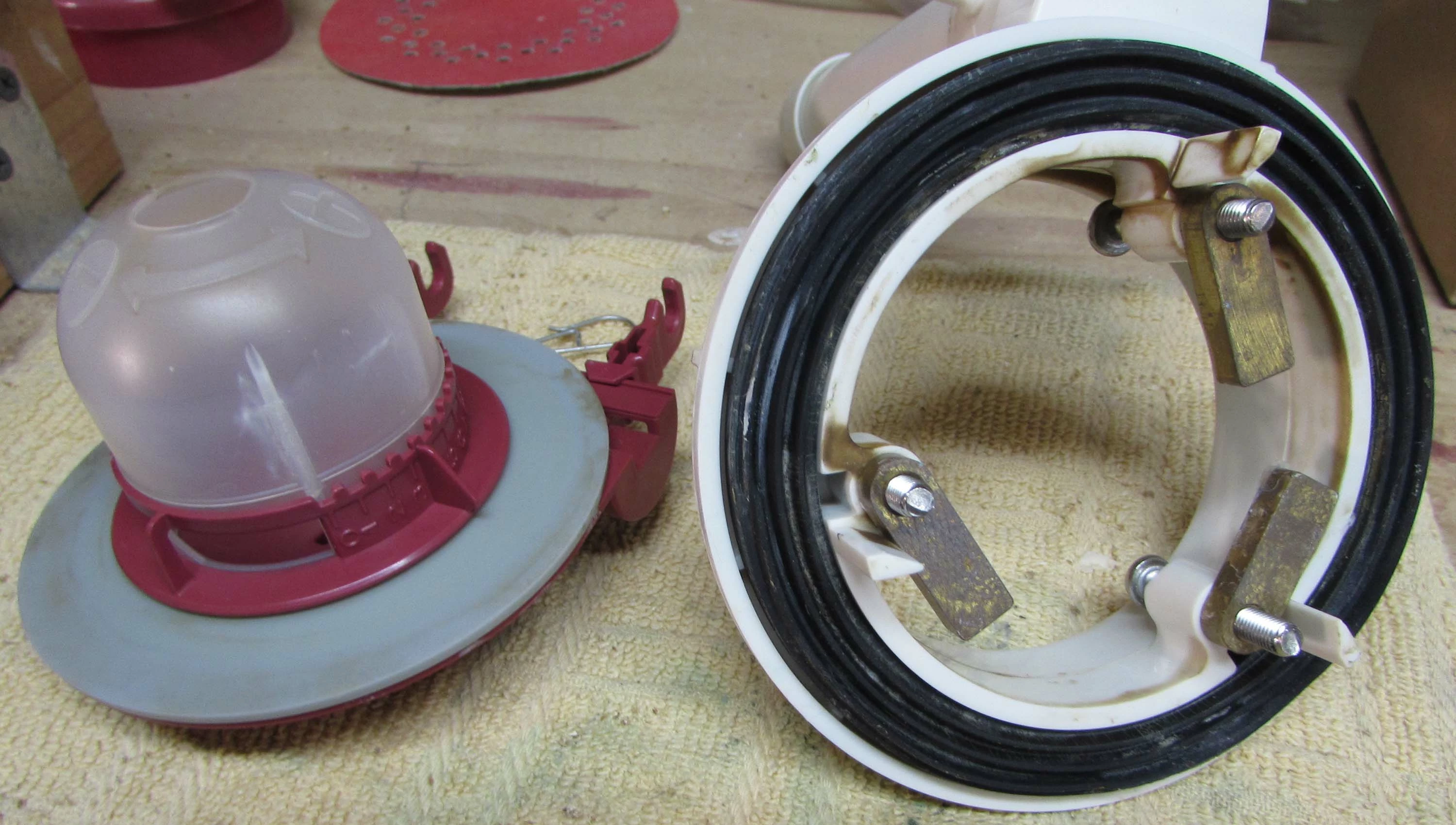

I never used an actual timer but 'about' every 3-4 hours the water would run to refill the toilet tank... I took the top off the tank and the water was going down about an inch and the automatic valve would then let water in to refill the tank
I did the first, obvious thing and bought a new flapper valve... did not fix the problem
So I did the next thing and removed the flapper valve assembly (see picture 1)
The outside of a toilet tank is shiny/smooth due to being dipped in a 'slurry' before going into a kiln, but the inside of the tank is NOT smooth, so the rubber gasket at the base of the assembly was clearly not making a good seal (note ridges in the rubber gasket)

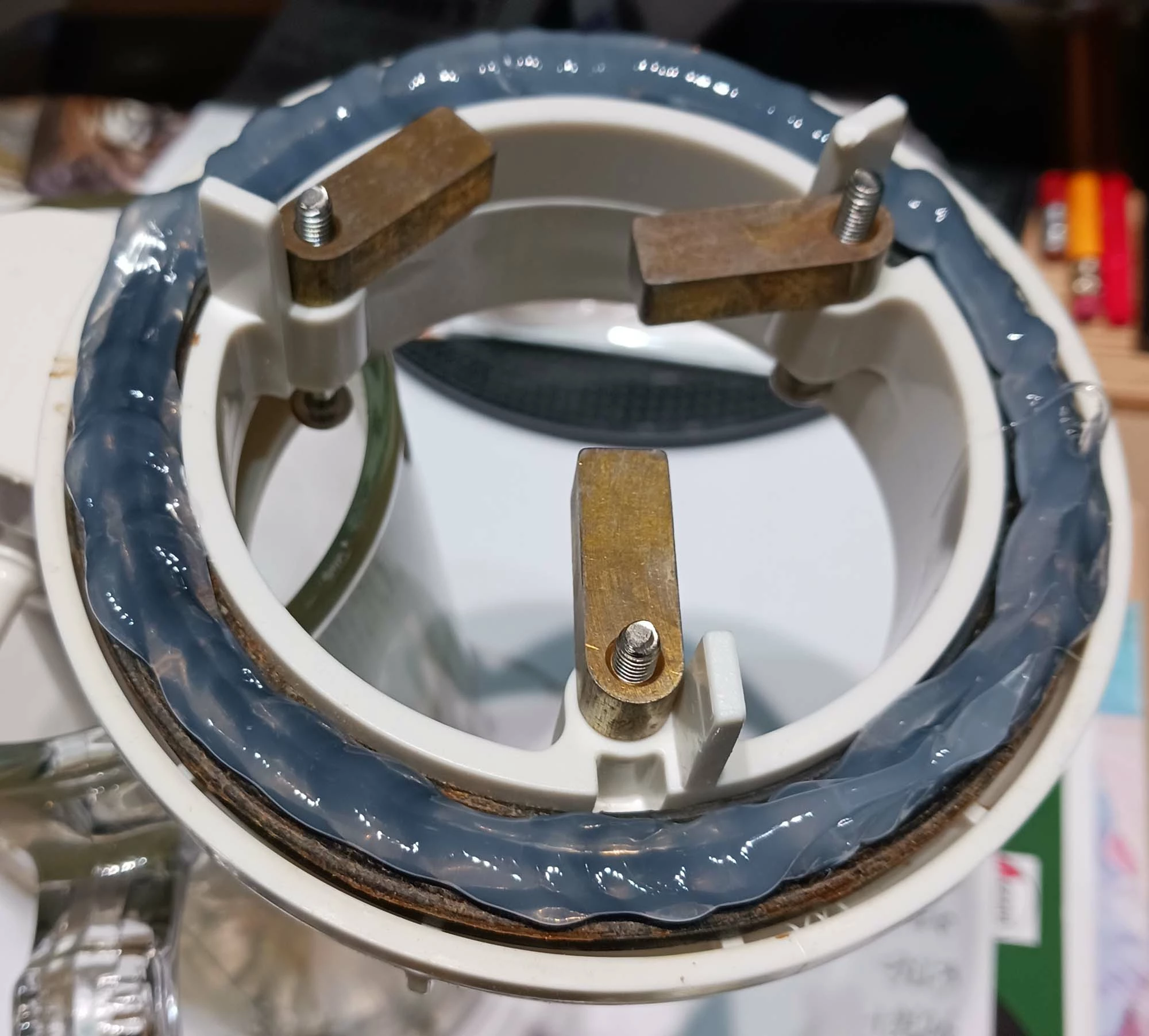

My solution (see picture 2) was to use shop towels to get everything completely dry and put a thick bead of silicone caulk on the rubber gasket... reinstall and let 'cure' for 24 hours before opening the water valve to let the tank fill
So far (2 days) the tank is staying full... leak is fixed !!!
