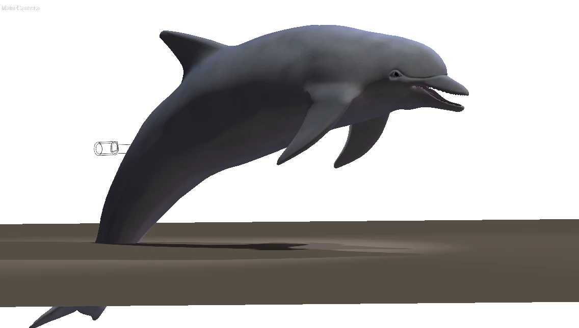

Using PS and Poser for stained glass project
I wanted to create several stained glass panels for some windows in my living room, where the sun came in to brightly. My wife wanted some dolphins, so I looked all over the web for images of dolphins, but really didn't find anything that I could use. Suddenly, I remembered that Poser has animal models, and sure enough, there was a dolphin model. So I used that, so I could pose the dolphins exactly how I wanted them - I don't have very good free drawing skills. So this is one sample of the poser model:
Here are my finished windows:
A little something different than just photography.
