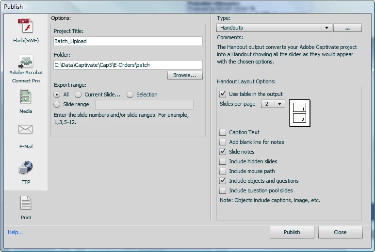

    You can have the slide notes under the slide thumbnails.  Set your publish options like the following:

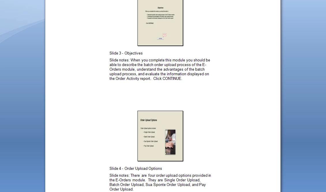

    In the Word document that gets created, it looks like this:
