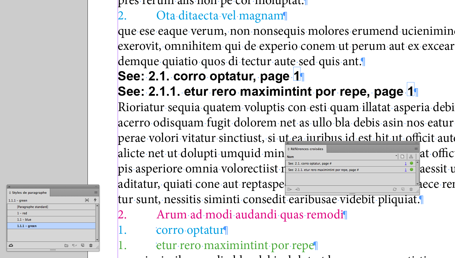

Personally, as usual, I'm not shocked and, once again, I disagree: it's totally and easily doable in InDesign! …
Just a matter of right auto-nums, a conversion to text and a simple grep style.
It could be done quickly manually but I'll do it myself by script and with just 1 click!
Have a good day!
Have a good day!

This is so far the best solution and one that works for a final document. I didn't think about converting to text and using a GREP! Unfortunately, this still doesn't satisfy the functionality I need. I should've explained earlier in the thread that this document will be considered a "living document" in that it could and will be revised over the course of 10-20 years. The key issue to this process is converting the numbered items to text. Once I convert the bulleted items, I can't add or remove any sections without having to go through my entire document. With 500+ pages and an average of 3-5 cross-references per page, this won't do. I might be able to maintain a DRAFT version and do a save as with a FOR_PRINT version, then do this conversion. I'll have to run some tests to see if this works.
In the meantime, we have shorter static prints from time-to-time and I'm most definitely going to employ this method until Adobe can find a solution. I'm sure many people dealing with technical and legal documents would pay big bucks for a third-party extension that can do this very process.
Thanks!
- Chris
Guide ,
Oct 22, 2018 Oct 22, 2018
Chris,
As usual with me, most don't understand what I mean! …
You can do all what you want! …
If you add or remove parts of text, no problem! …
What you need to clearly understand is that the conversion is only used to "save" the first numbering used in the cross-ref.!
Nothing else! … Most ignore that a "conversion to text" only makes the auto-numbering "sleep", absolutely not "remove"!
If the layout moves, you just need to play again!
That's why I could write a script [not really complicated: its steps are already in my mind].
It's not automatic [no need] but it's just 1 click! … and you'll keep your doc … definitely alive with cross-ref. that just need to be updated!
