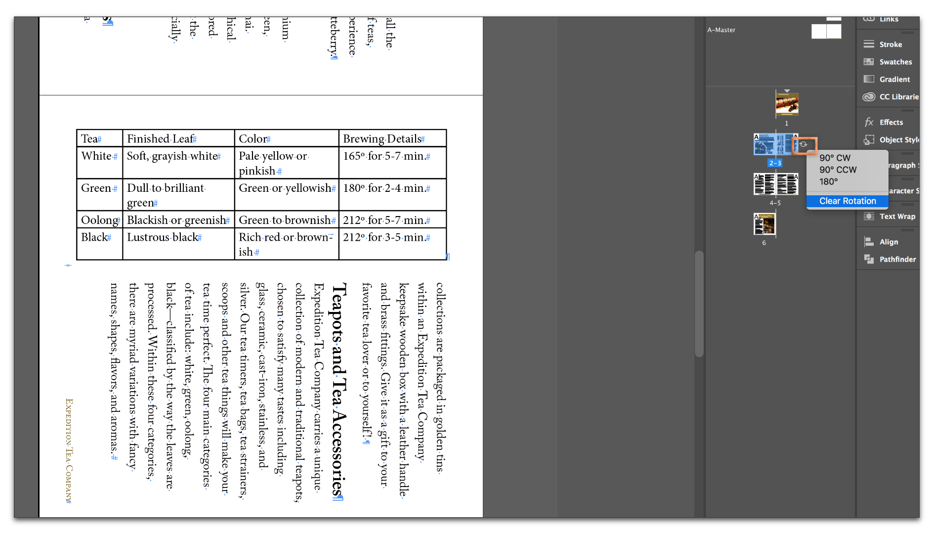

While that certainly works, I'm going to throw out one more option.
Instead of rotating the table to edit it, and then rotate it back, you can just rotate the spread. (And that's what the feature is there for.) Nothing moves, it's easy to edit, and when you finish, you clear the rotation. This also eliminates the possibility that the temporarily rotated table overlaps nearby elements and becomes harder to edit.
Right click the selected spread in the Pages panel > Page Attributes > Rotate Spread View > 90Ë™ CW
The entire spread is rotated, and when you finish editing, you can right click the widget that appears to the right of the rotated spread > Clear Rotation.
