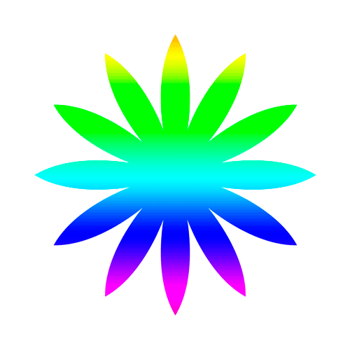

No you can't key-frame those property sliders.
If you are talking about a gradient fill layer, you can put that in a smart object then key-frame the transform property to rotate it (as below)
Dave

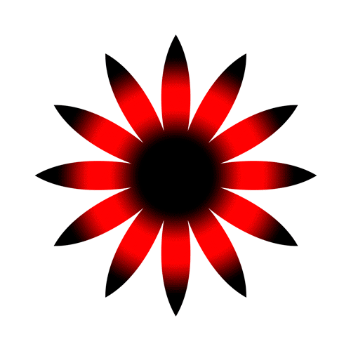

Sep 27, 2017 Sep 27, 2017
......and then I thought of another way
1. Make the gradient start and end with black
2. Put the gradient layer in a smart object , as before, and use key-frame and transform to scale the gradient
I did that below using 3 separate gradients with the upper two colours set to screen blending mode and also key-framed the opacity of the layers
That's enough - it's late here and I'm off to bed
Dave
