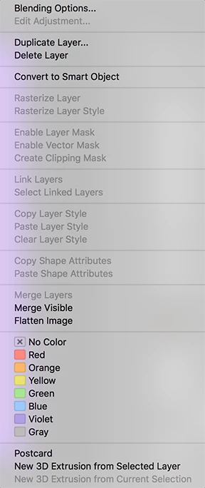

  • This is what the right-click menu for layers looks like (note that this was on an unlocked layer):

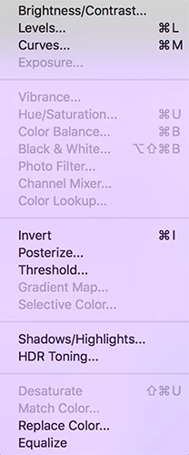

  • This is what the Image > Adjustments menu looks like:
  • In the above Image > Adjustments menu, the options that are not grayed out still have absolutely no effect once I click on them - the box pops up, but no matter how far I push the sliders the layer itself doesn't change.
