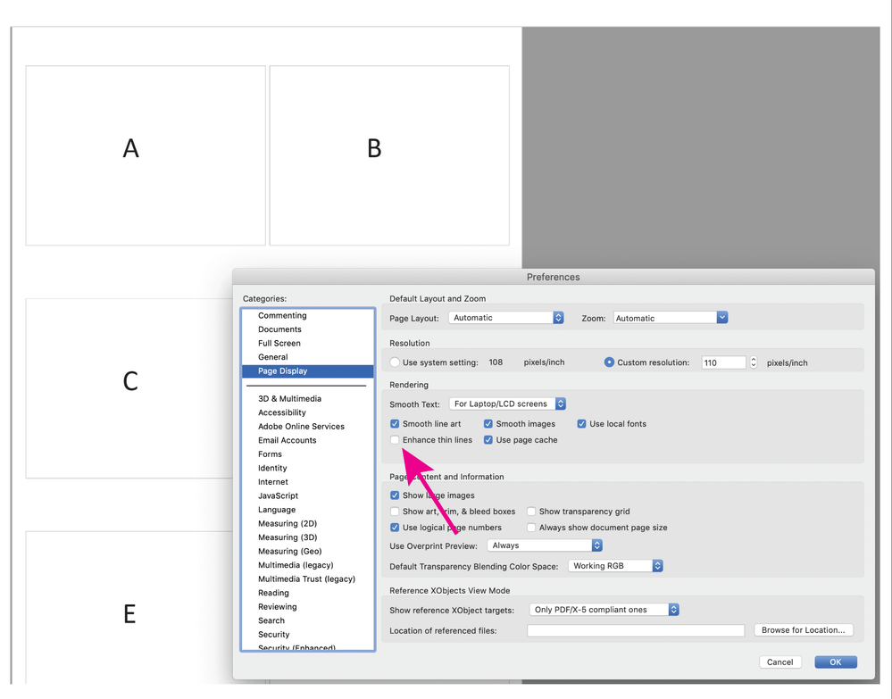

It looks like the size of your page borders are really small, they measure .3878 pt. but they are also getting cropped, so the effective size is less than .25 pt. If you turn off the page display preference to Enhance thin lines, the lines should appear in Adobe Reader (close and re-open the PDF after changing the preferences). I believe many printers will recognize very thin lines and automatically thicken them enough to print. Are you planning to cut the 3 x 2 pages on the lines? you might consider using crop marks instead.

Thank you.
I didn't realize it was a line thickness issue.
Thank you for your thoughtful reply.
