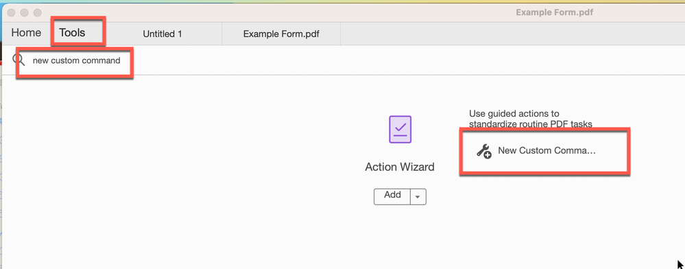

The easiest way to do this is to create a custom command:
Bring up the "Tools" tab in Acrobat and then type "New Custom Command" into the search field:
Then click on the "New Custom Command" item highlighted in the screnshot. This will bring up a new dialog:

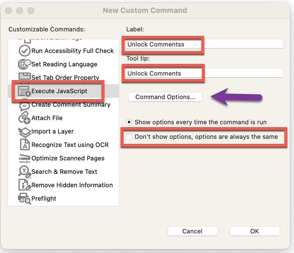

On this dialog, select to "Execute Javascript", then provide a label and a tool tip (I used "unlock Comments" for both), and select to "Don't show options". Then click on the "Command Options" button and enter the few lines of JavaScript from above.

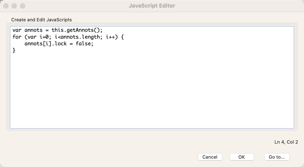

You can run a script in a custom command to unlock all comments. The following script, when either executed in the JavaScript console, or wrapped into a custom command will do that for you:
var annots = this.getAnnots();
for (var i=0; i<annots.length; i++) {
    annots[i].lock = false;

Hi! Thanks for your suggestion. I typed that into the "JavaScript Editor" but nothing happened--was that the wrong spot?

One of my comments has the script as text and you can copy and paste. Here it is again:
