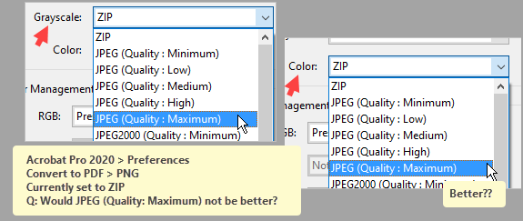

Up front, I do not remember where I got it from.... but all these years I have set the above as follows:
Scan Optimization: UNchecked
Compression
Monochrome: JBIG2 (Lossless)
Grayscale: ZIP
Color: ZIP
Color Management
RGB: Preserve embedded profiles
CMYK: Off
Greyscale: Off
Other: Preserve embedded profiles
Frankly, I never thought of anything else. However, I noticed there are also JPEG Quality Settings.
JPEG (Quality: Medium), JPEG (Quality: High), etc.
What are the best settings?
To be honest, I am not sure what 'ZIP' means.
Maybe ZIP is the best quality?
thanks

Mar 23, 2022 Mar 23, 2022
"To be honest, I am not sure what 'ZIP' means.
Maybe ZIP is the best quality?"
In a way, yes. ZIP is one of the oldest compression formats that is lossless. In fact, it's actually the basis of the compression technology used in PNG files. It's quite useful for images that have a lot of contiguous pixels of the same exact colour. e.g a black & white scan, or flat colour objects. For more photographic colour and greyscale images, where each adjacent pixel may be different, it's not as useful as it finds little to compress, hence the routines in JPEG compression are more successful.

I am talking about converting images -to- PDF, for instance combining a set of screenshots into a PDF.
In the screenshot the '>' should have been a ': ' , i.e Convert to PDF:  PNG
What are then the best settings for images?
Thanks again.

Both many thanks for the replies. Truly appreciated. My screenshots are set to be saved as PNG. With one or two applications I can not set the format as it is set by design (to JPG). My Epson scanning software stores the files as JPG. It is mostly (if not all) screenshots that I am talking about and personally I believe TIF may be some overkill.
I just created a screenshot - of the above answers - resulting in a 137.987 bytes PNG file and a 3.502.994 bytes TIF, a file that is roughly 25x the size of the PNG. Maybe this is crucial in the case of photos, but for screenshots...
Anyway, in this scenario, i.e. simple screenshots, I believe that PNG and ZIP would then be the best way.
