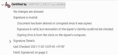

Community Beginner ,
Nov 30, 2021 Nov 30, 2021
Dear Amal,
I did as suggested, but still get this message:
Signature is listed as trusted.
