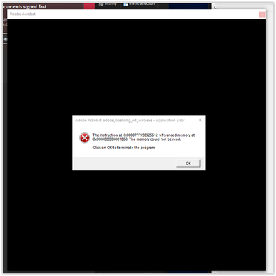

I'm having the same issue (Acrobat instantly exits shortly after opening) and tried the method you suggested.  I am getting the following error message (using windows 10).
I hope this helps Adobe Engineers since it appears this problem has gone unsolved since February 2024.  It shouldn't take this long to fix given the resources available to Adobe.   I am as frustrated as everyone else with this issue.  Come on Adobe!!!!!!!!
