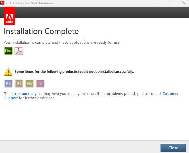

That worked, however there was a message:
It turns out those apps did install okay.

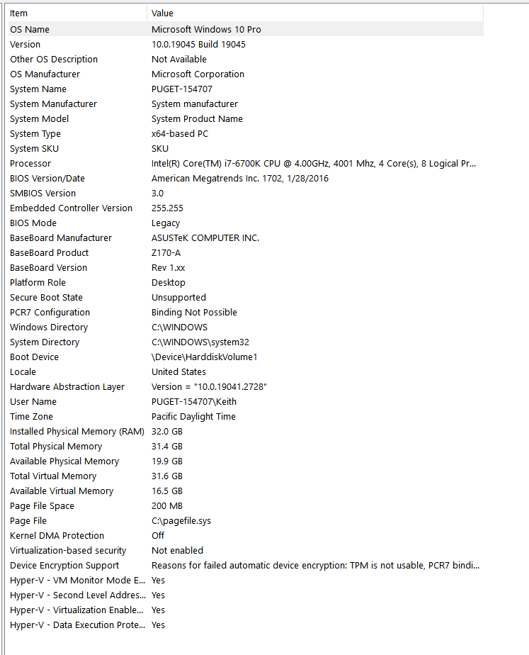

after start-up (with less processes/programs running), ps opened in under 15 seconds. and i have a pugent systems computer that i picked for quietness, not speed.
Guide ,
Sep 11, 2023 Sep 11, 2023
I have a Windows 10, 16 GB i5 CPU computer with SSD and when starting PS 24, it already takes 11 seconds before even the splash screen comes. I can only imagine your perhaps have a large swapfile, because mine is small. Don't know why it would take that long. I, however, have a lot of processes running.
i have more ram, for sure. 16gb ram is probably the main issue.
Guide ,
Your page file is also only 200 MB, same as mind. Typical size for an SSD. My RAM might be 16 only, but usually not used more than 50%. Never mind, it was just a comparison to CS6 which, of course, was also way smaller in everything related RAM use. PS nowadays loads so many unnecessary side feature related to cloud storage, libraries etc. It has a bad concept. The focus still is image editing, the other feature should be loaded on demand.
