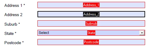

To give some context, we have a service request form that is used to collect the data. All the form names and replicated throughout the forms, however, some of the fields need to be merged. for example, on the service request, the client's address is requested across 5 fields. "Address_2" isn't always filled.
The data from the Service Request form is then exported to a data file which we use to import onto our Service Agreements and Renewals.
The form field on our Service Agreements and renewals is a singular field, as below.
I need to somehow merge the data gathered from the service request form as a string in to the above form field.

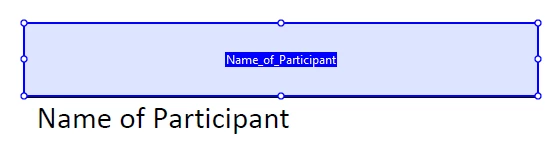

This is also the case for our client's name!
"First_Name" and "Last_Name" are requested as seperate fields on the service request form
I need to then merge these two fields into the one below
labelled "Name_Of_Participant"

//this was tried also as a custom validation script, on the "Address" field
event.value = getField("Address_1").valueAsString + ", " + getField("Address_2").valueAsString + ", " + getField("Suburb").valueAsString + ", " + getField("State").valueAsString + ", " + getField("Postcode").valueAsString;

I would suggest to use  a button field in file with address field and use this script as that button 'Mouse Up' event:
var cData = app.openDoc("EPM Service Request V4.pdf");
this.getField("Address").value = cData.getField("Address_1").valueAsString + ", " + cData.getField("Address_2").valueAsString + ", " + cData.getField("Suburb").valueAsString + ", " + cData.getField("State").valueAsString + ", " + cData.getField("Postcode").valueAsString;
You have named field wrong "Subrub", rename it in your file.
