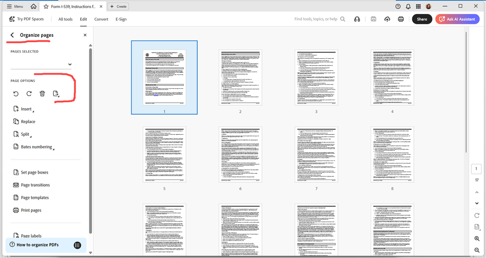

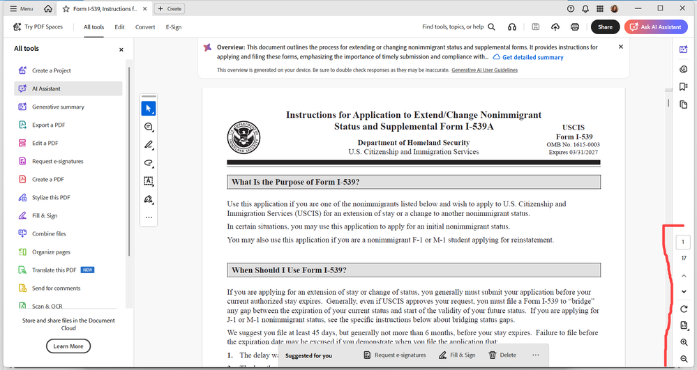

I opened this ticket originally and I need to provide some screenshots to close this.
I use this product quarterly to edit but just forget where the proper menus are.
First, This are the viewer tools (Notice the red mark).
Second, under Organizing tools are the edit tools (see red). ONLY here can changes be saved.
