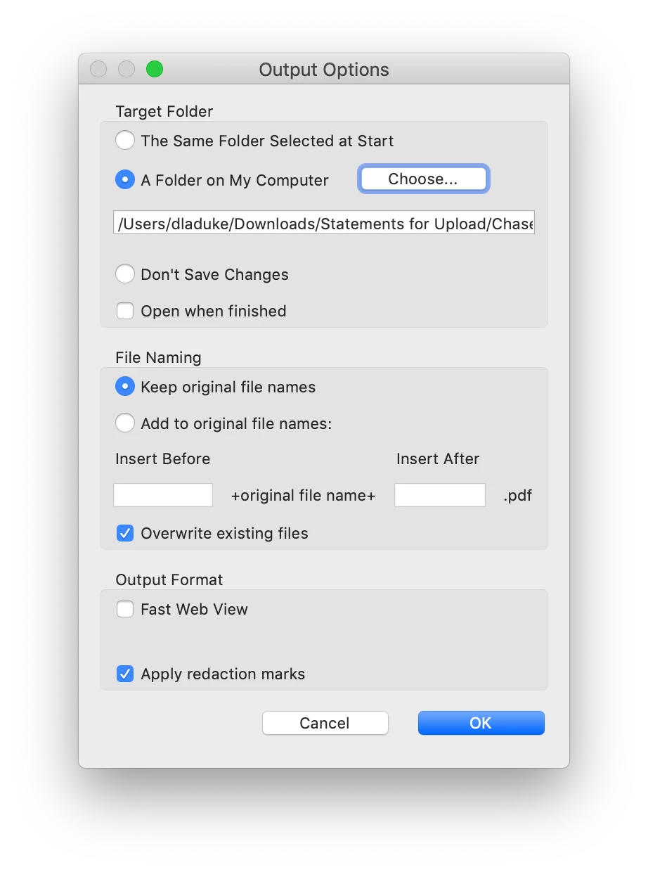

I figured it out myself! After you click "Mark Checked Results for Redaction", from the "Output Options" panel, check "Apply redaction marks". Works like a top! Redaction Automation is here.
Here is the dialog:
Here is the dialog:

Hi David,
Could you tell me how you got to that output screen? I'm trying to do the same thing as you, but not having any luck finding this screen or the output options.  I appreciate this is a year on, but working this out is proving a nightmare - so I'm hoping you can set me in the right direction.

Hi David,
How you got to that output screen? Thx!

Could you tell me how you got to that Output Options screen?
Thanks!
