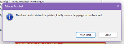

Help! I tried this and in the print preview it is now gray, however i get an error everytime i try to print and the adobe quits.
I don't see a way to revert it back to what it said before i selected Sgray

Is this an issue with a particular PDF file or with all the PDFs that you try to print? Please try to print a different PDF file and check. Could you share a screenshot of the error message for more clarity?
Please try updating the Acrobat application to the latest version 25.01.20630 from the help menu > check for updates, and reboot the computer once.
Also, check for any pending/missing updates for the printer driver and firmware, try updating them, and check again. You may also try to remove the printer driver, reboot the system, and reinstall it from the printer manufacturer's website.
Please go through the steps shared in the help page https://adobe.ly/47JuM9R

I followed these instructions (Preferences > Color Management > Working Spaces > at Greyscale: select "Sgray") and am now having the same issue as funny_Haven3282.  Here are screenshots of the error messages I get.  The first error message comes up and then when I click the Close button, I get the second message.
I checked for updates to Adobe and it says there are none available.  My version says 25.001.20643.

Did you ever fix the error and were able to print?  I am having the same problem, and now cannot print.

Would you mind sharing the version of the OS you are using? Also, please collect and share the print logs as described in the help page https://adobe.ly/4g2HyT3 so that we can get this checked further.
~Amal
