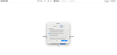

This is a very frustrating problem. Here is my fix for combining files into a binder instead of a portfolio. Note: the binder version combines the files into one single continuous PDF that you can scroll down instead of all the separate files. After you click Create Combine files,  click the OPTIONS button at the top and deselect Save as a Portfolio.  Finally, click combine and it will save it as binder.

When the acrobat window opens, you will see the wheel on top with the Options, click to change Option settings.  When the Options settings window opens, deselect the "Save as PDF Portfolio" option.  Viola - combining files will now automatically combine them as one instead of Portfolio.

When you are in the combince files screen, before you combining the files, click the Option icon and unclick the "Save as PDF Portfolio" button

ETA: Naturally, as soon as I posted I was able to figure out the solution: When in the combined files window click options and uncheck Save As PDF Portfolio. The combined file should now say Binder instead of Portfolio.
