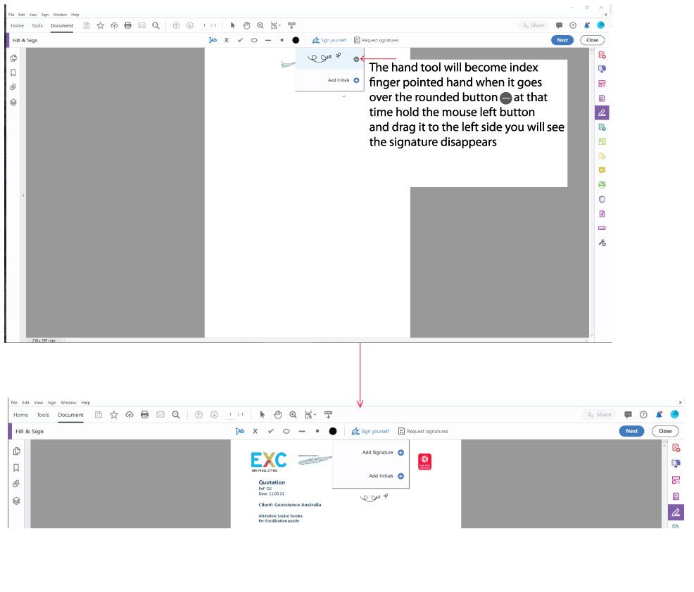

I think I figured it out! When the drop down shows the stored signature and initials, instead of just clicking the minus next to each, click and hold the minus button and slide to the left. That is the only thing that worked for me. Hopefully that helps.

I did this when the "-" was not reacting. But it cleared the 2 previously saved signatures/stamps.
Once you opened a pdf file, do this:

This works for me! I just pressed and hold the minus botton even if it was grayed out, and then it let me add a new one!
New Here ,
Apr 06, 2022 Apr 06, 2022
Same here.  I'm on a MacOS Monterey.  After choosing "Fill & Sign" or the "Sign Yourself" icon to get my existing signature images to pop up, I had to click and hold the gray minus sign next to the signature I wanted to remove.  That gave me the + icon to "Add Signature". (Sliding it to the left didn't work for me.) Very buggy and not intuitive at all, so a big thanks to y'all on this thread for helping me figure this out!  This is important--fix it, Adobe.

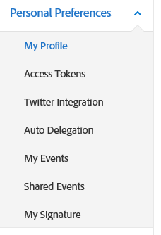

New Here ,
Aug 24, 2020 Aug 24, 2020
Here is what worked for me. In the top righthand corner click on your account, then click preferences.
Under account information click on E-signing settings
Then you'll need to sign in to Adobe and it will take you to your profile
Click on my signature and clear any saved signatures.
When you get back to the PDF, the signature should be cleares or at least have a blue plus sign instead of the grat minus.
