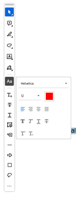

Click on the Meatball menu at the bottom of the toolbar
The customise toolbar menu will pop-up.
locate Annotations in the list and click on the drop-down button. highlight the "Set or change properties for the selected text" option and Click on the add to tool bar button
Select the text you want to modify and click on the Aa button.
Note, You might need to close down the document and start it up again if it's randomly dissappearing. A glitch in the software I believe.
