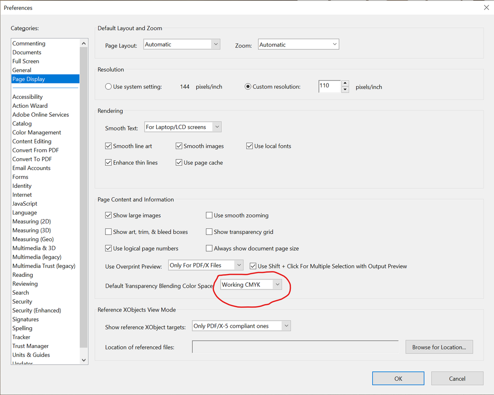

Aug 18, 2022 Aug 18, 2022
Hey, I just had this problem when exporting in CMYK for print. I resolved it by changing the "default transparency blending color space". Not sure if you tried it already but...Acrobat fix.png

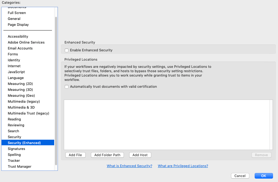

Nov 10, 2022 Nov 10, 2022
Hi - I also seem to have different settings under security settings (enhanced) and also have over saturated colours in adobe reader. Any help with this appreciated! Screenshot 2022-11-10 at 15.46.03.pngScreenshot 2022-11-10 at 15.48.40.png

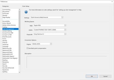

Feb 24, 2023 Feb 24, 2023
Hello! Unchecking "Sandbox Security" in the Security(extended) tab didn't work for me, but playing around with Color Management settings finally did. Try selecting different Working Space options, see what works for you.
Edit/ Preferences/ Color Management
Apple RGB worked best for me. The colors are not 100% the same, but I'd say 98% and are not oversaturated anymore.
