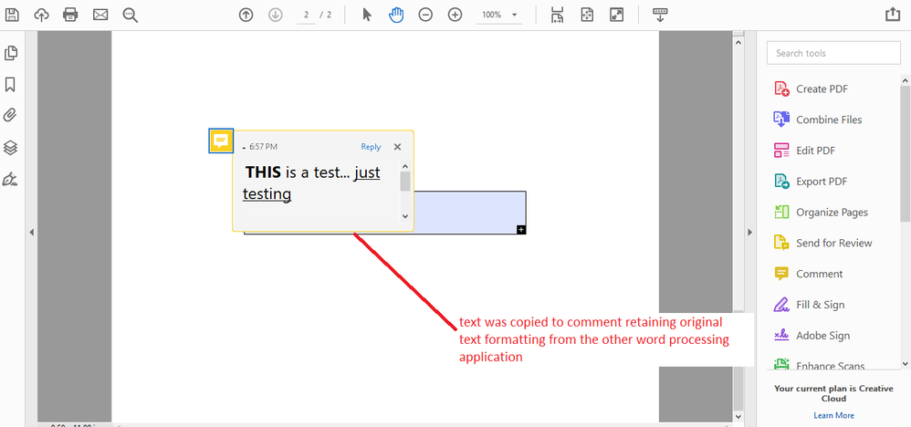

Hi, I am using Adobe Acrobat Pro DC version 2019.012.20040
The comments I wanna add are in a different format in a MS word document and when I copy paste them, the bold and italicized words in the original word document are originally there in the word document style and remain so when I click post, but when I close the comment pop up, the format resets.
I have shown this issue in a video here: https://www.youtube.com/watch?v=oGS1s4u2ojI
Why is this happening and is there a way I can preserve the font style when transferring content from a MS word document to the comments box in Adobe Acrobat Pro DC? It is very time consuming italicizing and making words bold again.
I am really in need of help and will appreciate a permanent resolution to this. Thank You! It has been months.

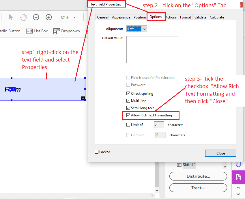

Please refer to the following slides:

I don't have a screen recorder at this time, but here is an additional slide to cover the step 1 that I did not illustrated:

Wordpad is the program that I used in the example to copy the text from. Like in your case you were using MS word. So wordpad dont have anything to do in this procedure. Maybe you are confused because I placed both program windows next to each other in the slides. The important thing hete is just to enable rich tezt formatting. You can do that by right clicking on any text field of your PDF document. That is really all you have to do. After that just copy and paste normally like you were doing ut in your video

Hey man. Sorry for the late answer so, the thing is when I right click in the PDF, I ain't getting the text field properties. How are you getting this? Are you using a different version of Adobe? Is there an alternative way I can reach the exact same settings?
Oct 12, 2019 Oct 12, 2019
In the bottom right corner of this slide below there is an icon like purple-pink color that I forgot to highlight for you. Look to the  right margin of your Acrobat work space and click on the search icon and type Prepare, you will see the "Prepare Form" action toolwill be listed.
When You select prepare form that enables the edit mode of your document which will allow you to right click on your form fields and access their properties

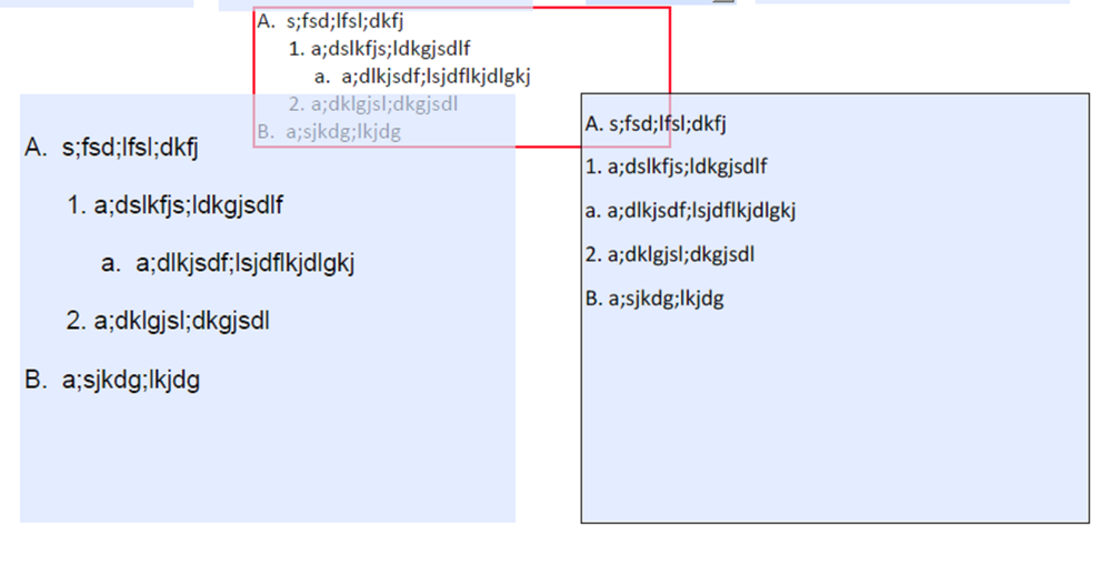

What if I am copying text from WORD like below and trying to paste in a PDF.  I can not get the formatting to stay and I am in a TEXT FIELD with rich text.
A.  s;fsd;lfsl;dkfj
      1. a;dslkfjs;ldkgjsdlf
           a.  a;dlkjsdf;lsjdflkjdlgkj
      2. a;dklgjsl;dkgjsdl
B.  a;sjkdg;lkjdg

the minute I paste it is all left sided with no indent or spacing.  Look below
D. Procedure
1. Inspection Requirements
a. Inspect each PPR and PS area on a quarterly basis, i.e., approximately every three months. Exceptions to this schedule must be authorized and approved by the EPL contract Principal Investigator (PI) and EPL Management and documentation to this effect included in the inspection records.
b. The inspection will take place near the end or immediately following the quarter being inspected.
There is no indention of the 1 or a. or b.
Oct 15, 2020 Oct 15, 2020
Yes, I get the same issue unless you paste to Notepad which will paste in plain text with no MS Word formatting. See image below.
The image of the textfield  to the left  is using the copy to Notepad method first  where I set my textfield as multi line with Rich Text formatting enabled.. The image to the right is displays the same problem that you're describing when I copy from MS Word directly into a textfield with the same properties as the one on the left.
The image in the center above the textfields is a free text annotation. It takes the indentations formatting but not the line spacing.

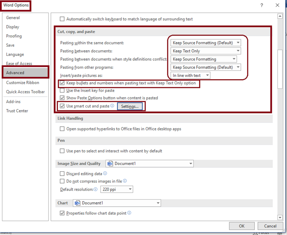

Ok , so this is what I found and is not related to Acrobat.
I think we finally got the correct answer to this old thread.
You can set a textfield in Acrobat as multi-line and with Rich Text Formatting. Then you need to modify the cut, copy, paste preferences in MS Word advanced options.
To do so go to "File" --->>> "Options" --->>> "Advanced" --->>> "Cut, copy, and, paste.
See image below to modify settings:

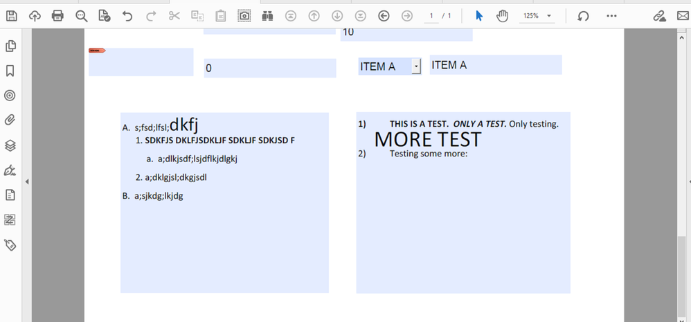

And below is my original document in MS Word with some text formatted:
And the result in Acrobat using textFields with multi-line and Rich Text Formatting enabled:
