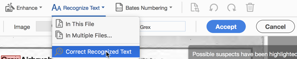

Alternatively, in Acrobat Pro DC, select the Enhance Scans tab and on the top, below the Recognize Text, dropdown menu, select Correct Recognized Text.

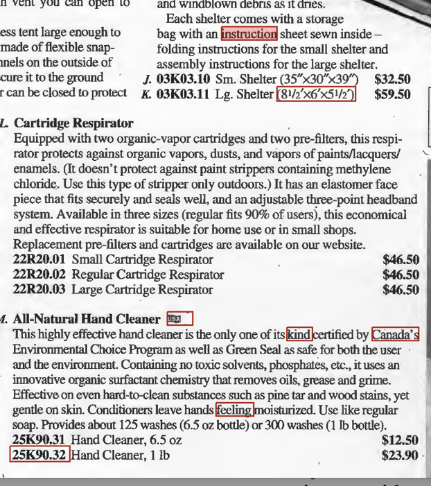

This will highlight all of the words that are questionable. Please note that the only two actual mistakes were in the shown section included the word "instruction" and lower down, after the text All-Natural Hand Cleaner there is a small graphic of "USA" also was seen as an error. All of the other selected text items were actually spelled correctly.

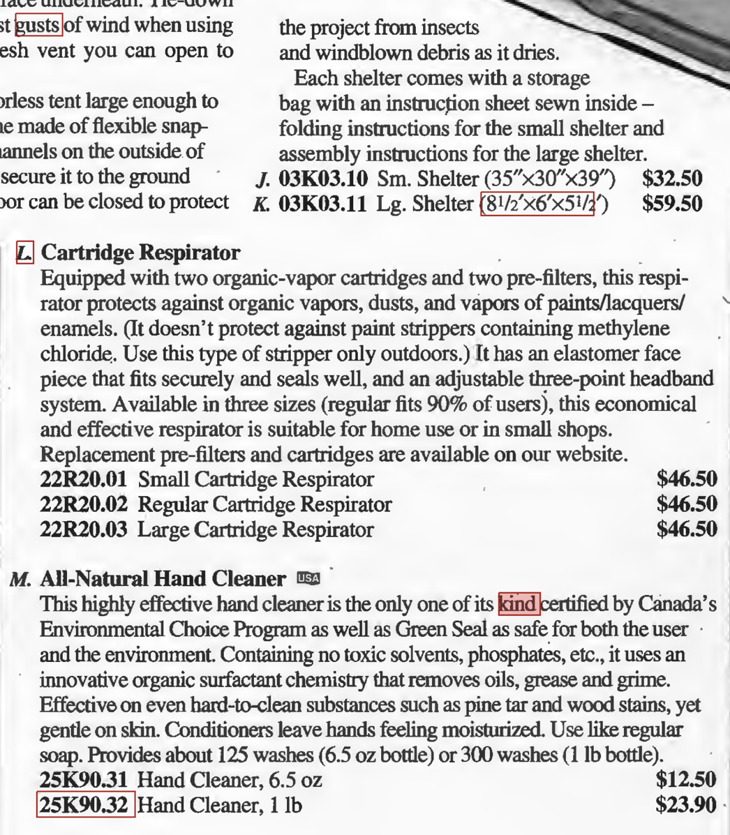

Let me also add that I redid the same scan but teased the Levels (or Histogram, same thing, different name) and improved it (I enhanced the contrast between the page and the text) and this improved the accuracy considerably: there were no actual errors at the same 300 ppi (although Acrobat did want verification on some of the items).
