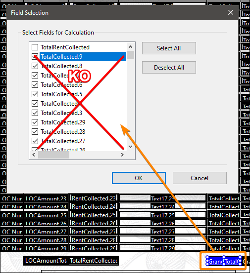

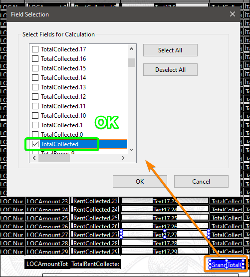

You don't have to tick each children field for calculation, just tick the parent field.
Two pictures are better than 2000 words:
Copy link to clipboard
Copied
@JR Boulay Okay, so this is amazing. This would have saved me so much trouble over the last dozen forms I have created. My goodness. THANK YOU.
