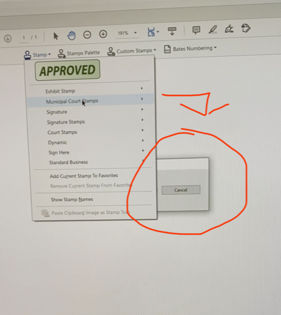

The path is correct, I have 2 documents in that same location with the same name, one has a .PDF extension, the other has a .png extension, when I make the extension a .pdf it works like it should. but if I change the code to .png it does not work.
But if I change the extension to a .png or .gif etc it does not work.  Does not throw an error, what it does, is when I go into a PDF file and then try to use the stamp, it flashes CANCLE 3 times quickly.
Here is the fixed script from above with the .png added.  even haveing .png in there does not seem to work.
Also see the attached screen shot of the cancle error flashing 3 times.AdobeStampError.png

Are you using this on Reader or Acrobat Pro?
All of the image import functions have a sordid history.  They have worked differently in different versions of Acrobt. Sometimes they required privilege and sometimes they didn't.   When I wrote the book, Reader would not convert images for the import. The imported image had to be PDF. But Acrobat Pro would do the conversion from any image format. Also in DC the image import works differently in the Stamp context than a document context. For example,  in the stamp context the buttonImportIcon function won't work if the path is not specified. I think JR wrote an analysis/rant on this years ago.  None of this is properly documented and it's highly likely that things have changed in the latest update.
I've tested the buttonImportIcon function recently from a document context, but not for a stamp.  And unfortunately I won't be able to get to it until later next week.
The easiest work around, and the best protection from future Adobe shananagans, is to convert your signatures to PDFs.  In fact you can use the Signature Stamp tool to produce beautiful stamp images.
https://www.pdfscripting.com/public/PDF-Signature-Stamps.cfm
Then you'll also have a sigature stamp.
