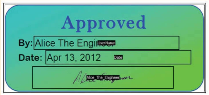

Im working on setting up a Stamp that will pull the users Signature from a network folder.  I bought the PDF Stamps gone wild bookd an used the code below.
The code works if your signature are in a PDF format... The problem im having is all of my users signatures are in the PNG format not PDF.  when I change the code below from PDF to PNG, it does not work.
How would I use the script below to insert a signatre stamp image where the image file is a PNG and not a PDF?
