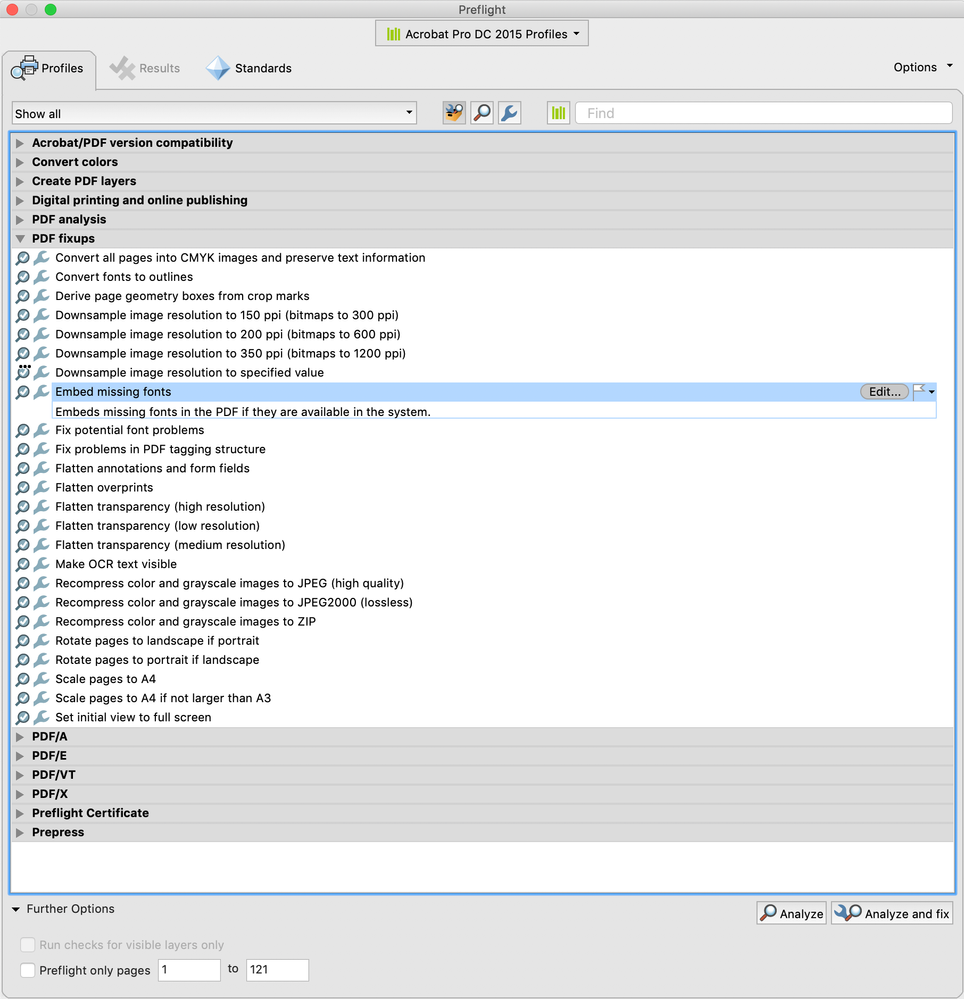

It looks like your PDF has some unembedded fonts. This could be because the PDF was not properly created from Word, or was optimized for size. I ran a preflight fixup on the PDF which may have fixed the issue (Tools> Print Production> Preflight> Fixups). Unfortunately the Preflight tools are not available in Reader.

Hi, thank you so much for the help and reply! The file also got fixed. Would you know what happened though since I could previously just open the file just fine and then it became as above some months after?

I don't know what changed, unless someone optimized the PDF in Acrobat and unembedded the fonts, or something changed on your computer that removed some needed fonts?
You can use Reader to confirm a PDF has embedded fonts, go to File> Properties> Fonts, all the listed fonts should say Embedded or Subset.
