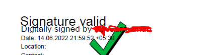

Dear Adobe Community,
I will work in CA firm last 8 year and same issue last 5 year. finly i got the solution.
Simple stap for Green Tick is update watermark file in Adobe PDF logo to Green Tick Logo.
link and stamp file attached https://www.adobe.com/devnet-docs/acrobatetk/tools/DigSigDC/appearances.html

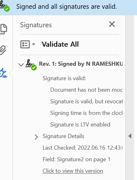

I tried but it is showing the below with Adobe logo refer the (1st image attached below). My requirement is Valid with Green tick Mark symbol (2nd image attached)
Thanks
Shahul
