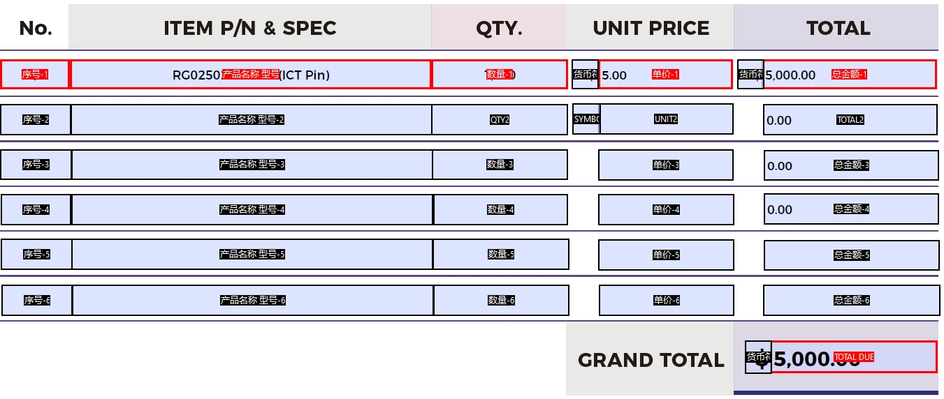

I'm making an invoice form with Acrobat, it's my first time to do it.
I have no idea how to achieve what I want.
See the below image, sometimes we only have one product to write on.
I don't want the other lines to show anything.
However, I set "TOTAL2" Calculation as QTY2*UNIT2,
though no.2 has no item, TOTAL2 still shows as 0.00.
1.
I want it can show the correct multiplication when I have to enter row 2(shows the value of QTY2*UNIT2); if row 2 is blank, I hope TOTAL2 is blank, too.
**Update**
OMG with JR_Boulay help, I tried to combine this and that script(know nothing about the script) and I found a way that works!!! Not sure if it is a correct way, but it meets my demand.
var t = this.getField("QTY2").value*this.getField("UNIT2").value;
event.value = t;
if (event.value == 0) {event.value = ""};
This can make the TOTAL2 column remain blank if there's no data of item 2;
also, it'll do the multiplication script when item2 exits.
2. Similar problem with the small square "SYMBOL", at the left side of "UNIT2".
Because we use a different currency, so I should make it changeable.
I copy&paste it, so it will show the same result of the upper currency symbol.
However, if row 2 is blank, it still shows.
So I delete the copy one, make a new text field, but have no idea how to deal with it.
What I need is, the SYMBOL column remain blank if there's no item2;
if I have to enter item2's data, I want the SYMBOL column to show the currency symbol, which there's already a CS column in the form, I entered it manually. I hope the SYMBOL column can sync with the CS column.
**Update**
I found a way to solve it:
var t = this.getField("QTY2").value;
var s = this.getField("CS").value;
if (t == 0) event.value = "";
else event.value = s;
not sure if it is correct but the same, it meets my demand.
Please show me the exact javascript codes to me, many thanks!!
[Solved, JR_Boulay 's answer]3. Could anyone tell me, if I finished the form, before I send it to my client, what should I do to prevent others to edit my form while they can sign&stamp on it???
I tried to search the method for the above 3 problems online, but after trying those codes, they didn't work. My bad.
Thank you!
JR Boulay
June 24, 2020
3- If you're using Acrobat Pro you should flatten the form before sending it.
leahfong
leahfongAuthor
June 25, 2020
Thanks! I tried and it works.
JR Boulay
June 24, 2020
1- Place this script as a custom validation script in each calculated field:
leahfong
leahfongAuthor
June 25, 2020
Thank you!
But some calculated fields need this script and multiplication script.
Do you have any idea to combine these scripts??
