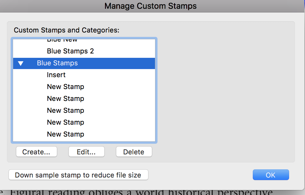

If I go to "manage" stamps in Palettes, I see this:
Each of these sub-stamps is a different image. I guess I never named them after Insert, as it seemed too tedious. What I need to get to is to see a New New stamp with the desired stamp image, somehow saved to this list.
Update: I see that the final new New Stamp has added the new stamp sign (a par. marker). So perhaps your method added it to the file in App. Support/..../Stamps.
But I don't see this new image in the Stamps Palette called "Blue Stamps".
