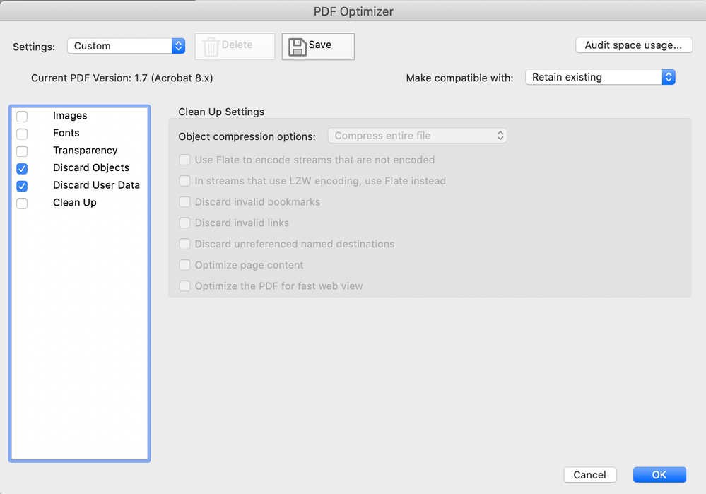

This is just a guess, but try saving as an optimized PDF (File> Save as other> Optimized PDF). One of the settings may remove the unwanted info. If it works, you can create an Acrobat Action to easily apply it to a PDF or folder of PDFs.

Thx a lot for your answers! But that is not enough. Unfortunately, the data is still there. I tried both ("Save as" and "Save optimized"). Still I am able to find the unwanted, hidden data...
