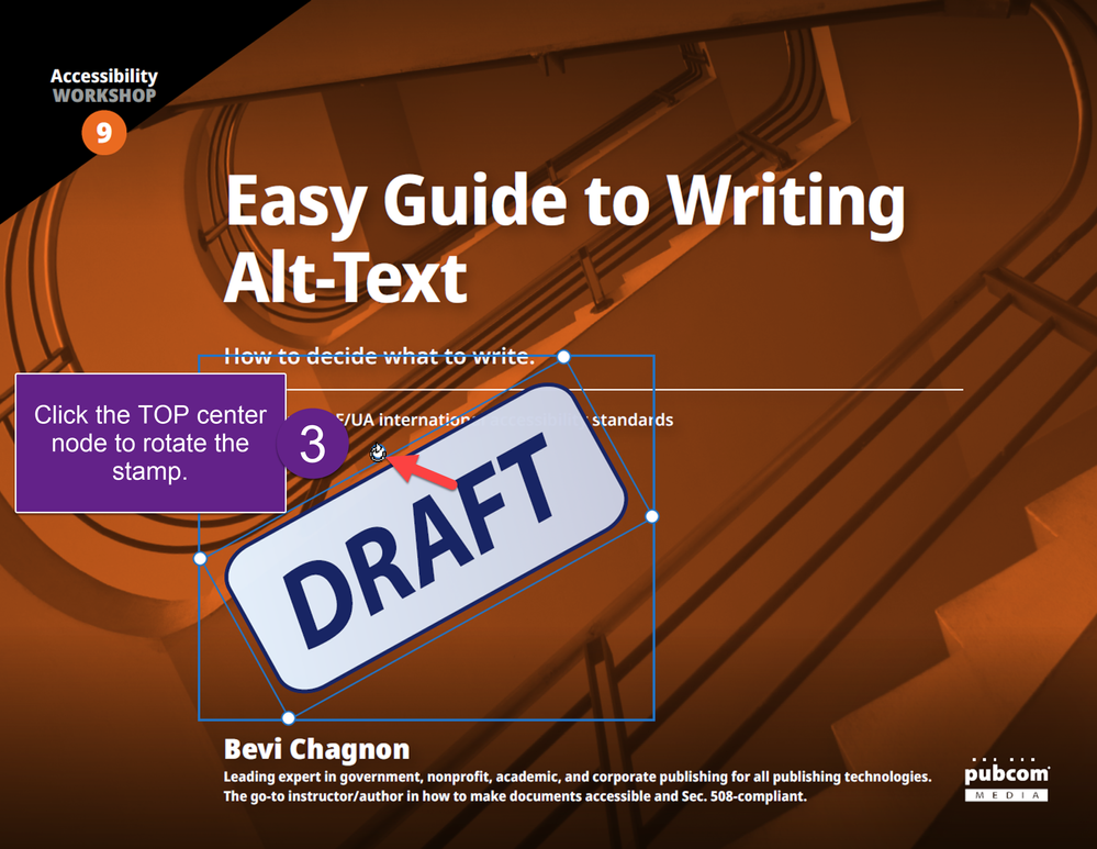

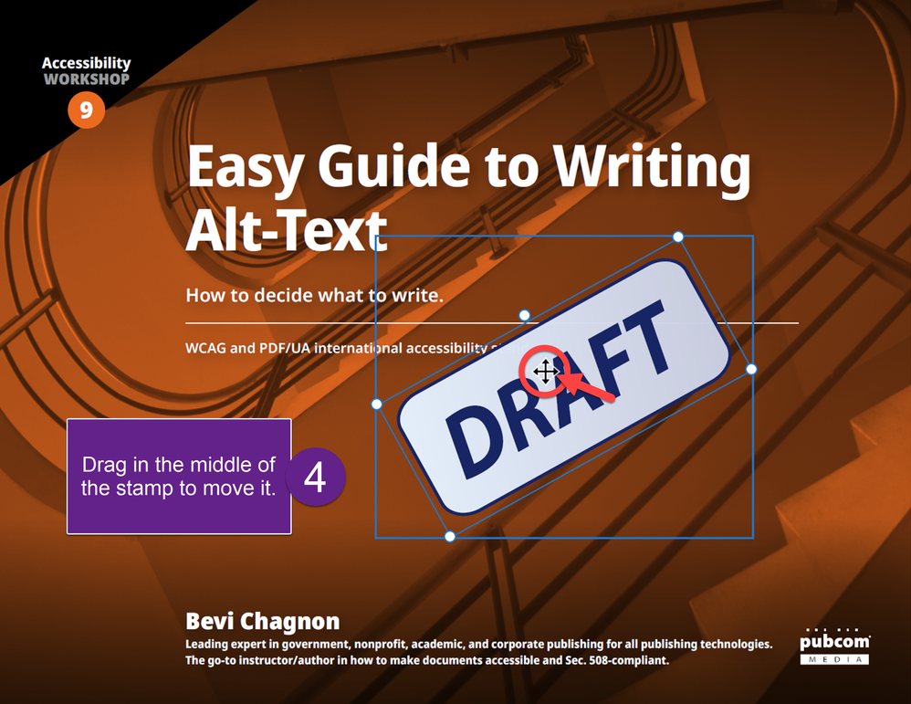

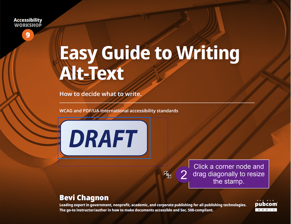

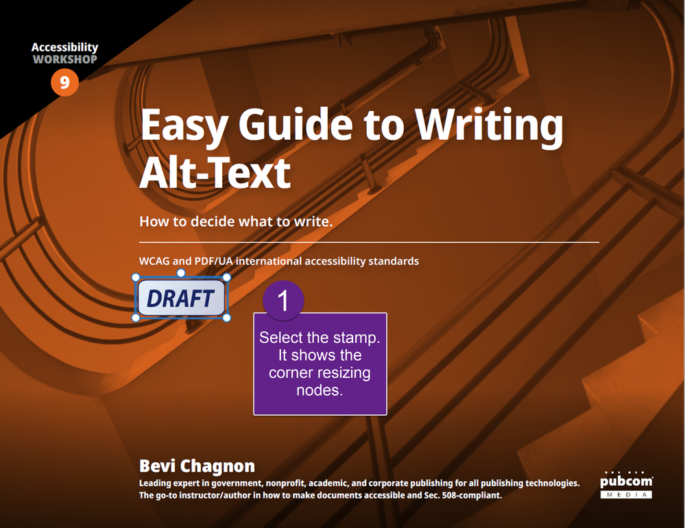

Easy way:
No matter what size your original graphic was made, and what size it became once placed as a stamp in Acrobat, you can easily resize the stamp in Acrobat.
  1. Place the stamp and select it. The risizing nodes appear on the corners.
  2. Grab a corner node and drag it to the size you want.
  3. You also rotate the stamp by grabbing the top center node and rotating your cursor clockwise/counterclockwise.
    4. And you can move the stamp anywhere on the page. Click the stamp in the middle and drag it.

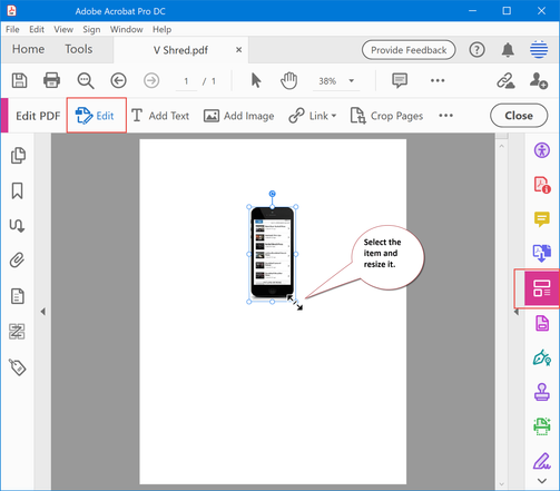

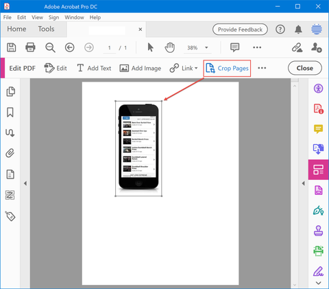

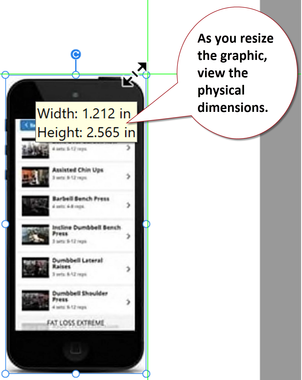

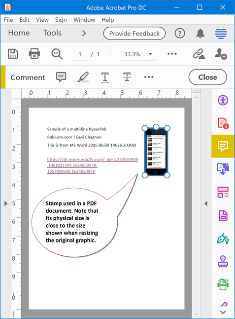

So here's another method that you might find more useful.  I assume you're creating static stamps, so we'll go with that method.  Create your stamp with any size image you have.  Then open the stamp file and use the "PDF Edit" tools to resize the image to the size you want for the stamp. Acrobat has handy rulers to help you with this, so it's pretty easy to do.  The size of the content on the stamp page in the stamp file, is the size of the stamp when it is applied to a PDF page.

You need to resize the stamp file Acrobat created, or resize the image you used and then create a new stamp from it.

What do you mean "mind blowing"? The size is a pretty natural thing. A stamp is a PDF page, so the size of the stamp when placed is the size of that page.
You didn't need to resample your image down to create a 20x20 stamp You have other options. For example, create a 20x20 button, then use the full size image as the icon. Or, a better option is to create a PDF page from your full size image, then use the PDF Edit tools to select and resize it to 20x20. These are both options that scale the image for viewing, while preserving the orginal size.
