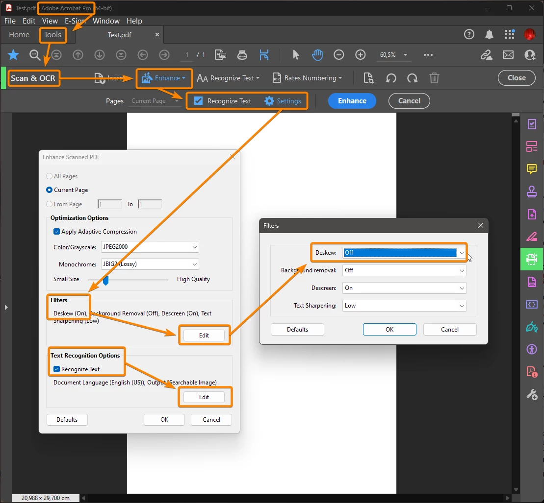

"I do not know of a way to turn off that auto-rotation feature in Acrobat."
You can but in a different process:
1- scan your documents leaving images untouched (no OCR, no optimisation) and save as PDF,
2- run the "Enhance : Scanned document" tool to OCRize and optimize, there are more settings than in the "Recognize text" tool. See below:

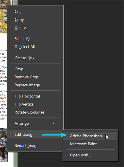

Since these pages are scanned images you should not "Edit in Acrobat".
Using the Acrobat "Edit" tool you should make a right-clic on the page/image and choose "Edit using : Adobe Photoshop".
Once the change has been made in Photoshop: Save and Close to transfer the change to the PDF file.

Sep 22, 2023 Sep 22, 2023
Document Geek Damien665
