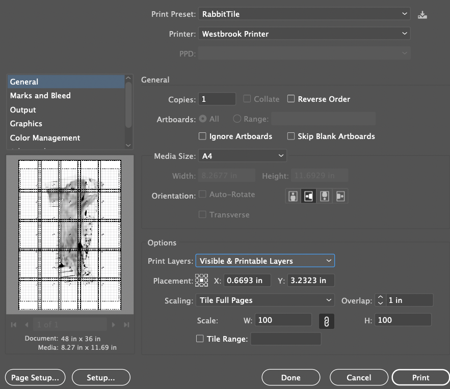

I have exactly the same problem as SuperGraphic.  Using Illustrator 25.4 on an up-to-date mac, with a Canon Printer.  See the following screens.  But it's always printing duplex.  I'm unimpressed.look1.pnglook2.png

Did you ever resolve this - I have the same thing happening right now. epson printer just like you - print both sides is NOT checked but it insists on printing my tiled set up as double sided

The control is in the Setup dialog.

No, that still does not work. - for instance, when using tile-imageable areas.
