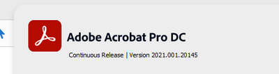

Also Im using this version of Adobe Acrobat and I don't see a calculate tab when going into the properties of the text box
New Here ,
Apr 09, 2021 Apr 09, 2021
I found how to bring it in "revert to acrobat form" but it would help great if i can get the calculation from prior. I will no longer use the employee's rating to calculate the final overall score, it would just be the managers. same number of questions and weighting and using a drop down from 1-5. Thank you for the help so far.
