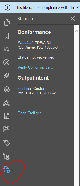

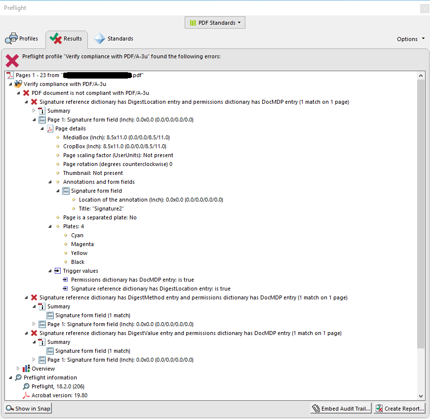

Here is a screen cap of the preflight indicating the issue.
Is there a way to certify PDF/A-3u files that doesn't break conformance with the standard?

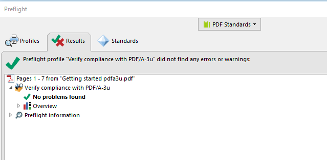

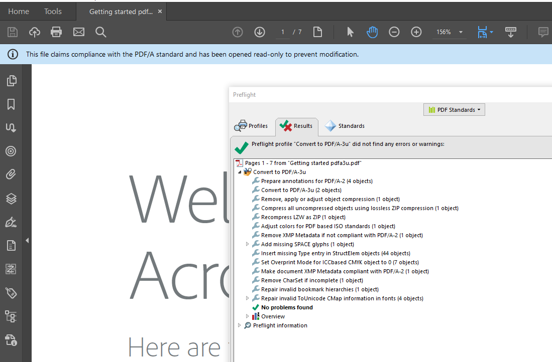

I tried replicating the issue on Windows 10 machine with Acrobat DC latest version 19.008.20081 and the issue was not reproducible.
Please find attached the screenshots for the same.
You may try with another pdf file to check if this behavior continues. Also, check if an update is available for Acrobat using check for updates option under Help menu. You may also download the updates from here: Adobe software and product updates

Thanks for taking the time to reply to my question. We are able to convert to PDF/A-3u successfully but after certifying the PDF using Acrobat Pro DC, it is no longer compliant with the standard. So, the issue is with the certifying process, rather than with the conversion to the standard.
After speaking with Adobe support, we were able to prove that Acrobat can apply a document signature to the PDF without breaking the standard but not a Modification Detection and Prevention (MDP) signature/certificate. When applying our digital signature in that way, Acrobat is adding a DigestLocation, DigestMethod, and DigestValue to the signature references dictionary. That's not permitted by the PDF/A-3u standard. Do you know of a way to prevent Acrobat from doing that?
