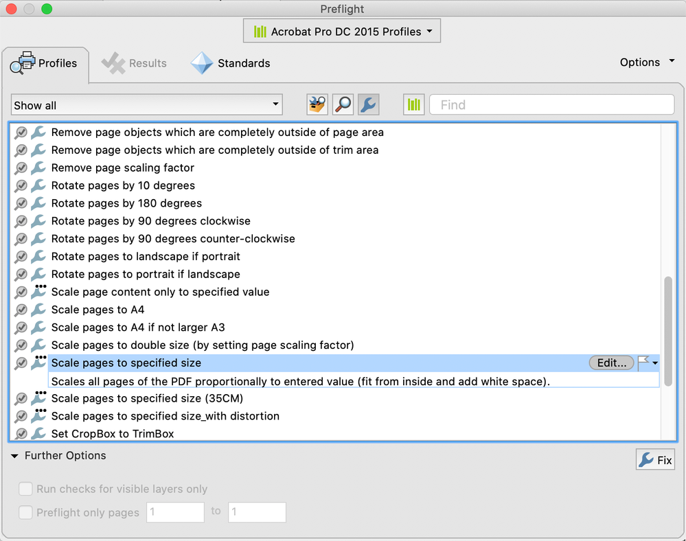

Acrobat Pro DC has a Preflight profile that can scale all pages in the file to have the same page size.
Aug 14, 2021 Aug 14, 2021
Thanks for posting your solution. You could also substitute InDesign for Word to accomplish a similar result.

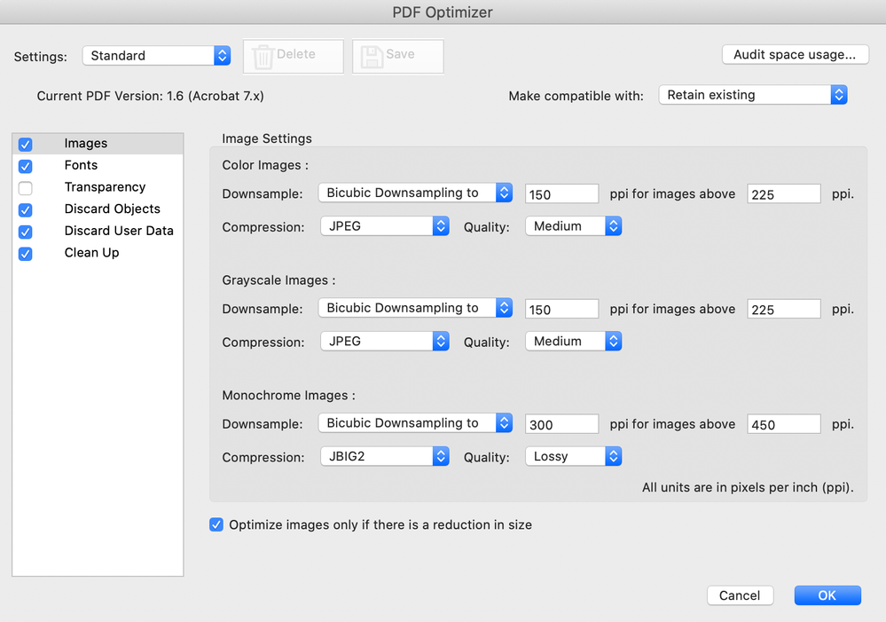

To elaborate on try67's suggestion, go to Tools> Print Production> Preflight> Fixups, here you can use one of the existing profiles to scale and/or rotate the PDF pages as desired. You can also duplicate an existing profile, re-name it, and adjust the settings. As for reducing the size of the new PDF, go to File> Save as other> Optimized PDF, where you will have very good control over downsampling, compression, and removing unwanted PDF overhead. You may see significant reduction by just selecting all of the Discard Objects, Discard User Data and Clean Up options, unless there is something specific need to keep. In addition, if any of the certificates are vector (not images) it would be best to keep them vector (for best quality) and I'm not sure this would happen if they are placed in Word and converted to PDF.
