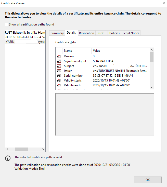

I have token which contains digital signature with SHA384 ECDSA (elliptic curve) encryption algorithm.
I am trying to sign pdf on adobe acrobat reader dc also adobe acrobat reader dc pro versions with this token bu after entering the PIN code, I get the following error message:
Error Code: 2148532258
"This smart card does not support the requested feature."
But in adobe's web site, it says that it supports elliptic curve algorithm
https://www.adobe.com/devnet-docs/acrobatetk/tools/DigSigDC/standards.html
Does anyone have any ideas? I am a newbie to understand or solve such problems, so can anyone give brief description?

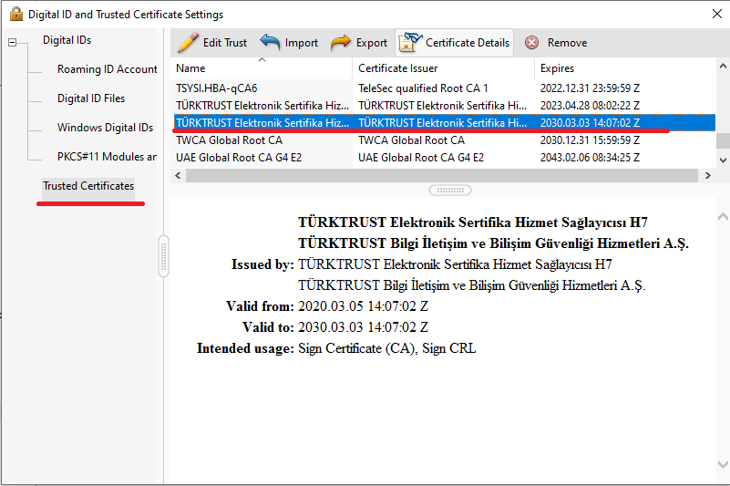

The error above doesn't really suggest that this issue  is generated from the Adobe Acrobat program. Seems to be related to the smart card itself.  That said, are you able to use this smart card successfully with other programs when you apply the digital signature to a document  with that certificate?
If it is only happening with Adobe Acrobat Pro DC or Adobe Reader DC, the I must ask if you're importing the security settings for the signer's identity from a file or from a server?
If YES, look in the same link that you posted as a reference the following section:
Also, see this other section to identify if the certificate is getting the correct publick key hash:
Last, can you please provide the brand and model of the smart card reader and the type of smart card that you're having the issue with?
It may be possible that the smart card reader needs its drivers updated. That is some guidance I read in a Microsoft support forum for another user with the exact same error as yours.
However, if this is a government issued smart card, I believe that the most important detail(s) are found on this page:
Verify if you have a smart card identified in the list of cards that won't work. If it is, then the smard card need to be updated.
