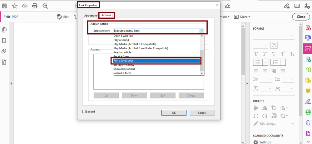

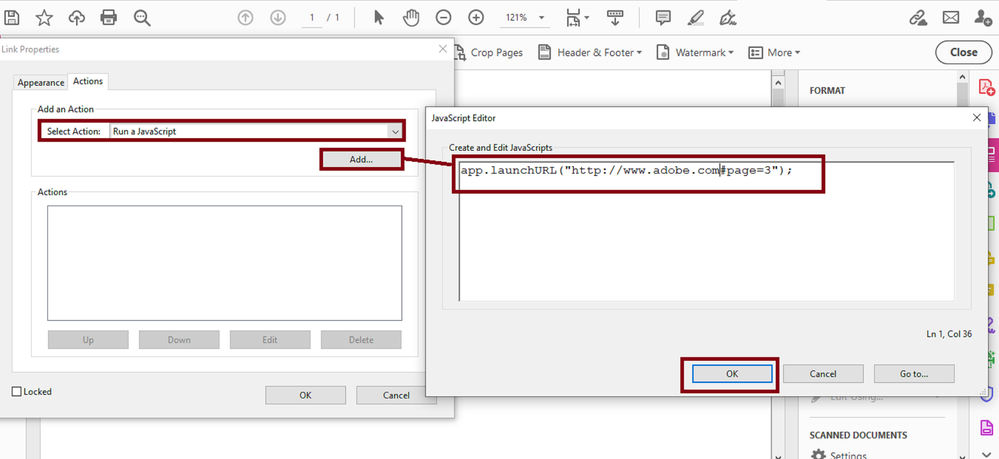

Hi everybody!
I'm sorry to break the cheerful mood and be the actual party-pooper that is about to ruin the partially fructiferous pseudo-victory here.
I don't know how you're able to get over 18K views by suggesting a third-party solution in the Adobe community support forums.
I am 100% positive that if it was me who posted that link here, a lineup of MVP's and ACP's would've jump already to tell me that I can't do that, and 12 months later I would still be wondering why does my answer was never marked as a correct solution.
This problem has nothing to do with a particular operating system platform; I confirmed that it happens using any version of MS Windows 7 through MS Windows 10.
So it is most likely that a bug was introduced via recent updates of Acrobat Pro DC or no-one has ever cared to look into this since 2012...
Anyway, according to another user that I was helping out yesterday, the problem doesn't manifest with Acrobat DC 2017.
The person had uninstalled Acrobat Pro DC as a "band-aid" remedy (I quote). Moreover, in an environment where a user has to process thousands of documents with URL web links, bytly.com imposes a cap to a maximum limit of URLs that a user is able to fix using their service.
Here is my post to that person 3 hours ago before I posted in this thread:
When you reach that limit you have to subscribe and pay; this is not a convenient solution for mass production of PDFs with weblinks. So, I am going to post here the real work around using very basic javascripting ( I am just learning JavaScript by the way).
If this problem is indeed a bug, when you use the Create Web Link wizard from the "Edit Tool" it seems as if something is not converting the hash or pund symbol appropriately to the corresponding Unicode symbol .
If that is the case it is likely that the symbol is not available in the current font or typeface that is currently used by the JavaScript editor or by the PDF document in general.
So lets us take a look at the slides below:
If you refer to a Unicode table, look for the ASCII punctuation and symbol symbol section for " # " (without the quotes" ) you will notice U+0023 <<<---------- SEE THE RELATIONSHIP WITH THE %23 NOW???
See a lot more here:
As you can see, this problem has nothing to do with web servers, plug-ins, MS Office add-ins, browser add-ons, macros, Active X control in Windows, and what not.
This is most likely a bug like I've suggested earlier, and I am mostly inclined to think it is between HTML and the JavaScript UTF types that are involved in this web linking process with Acrobat (but I may be wrong).
However, the best workaround at this time is to use a javascript script instead of using the "Open a web link" method.
See the additional set of slides that I prepared and use this other method instead:
// YOU CAN USE THIS EXAMPLE URL TO TEST AND SEE FOR YOURSELF IF IT WORKS
app.launchURL("http://www.adobe.com#page=3");
IT WORKS!
