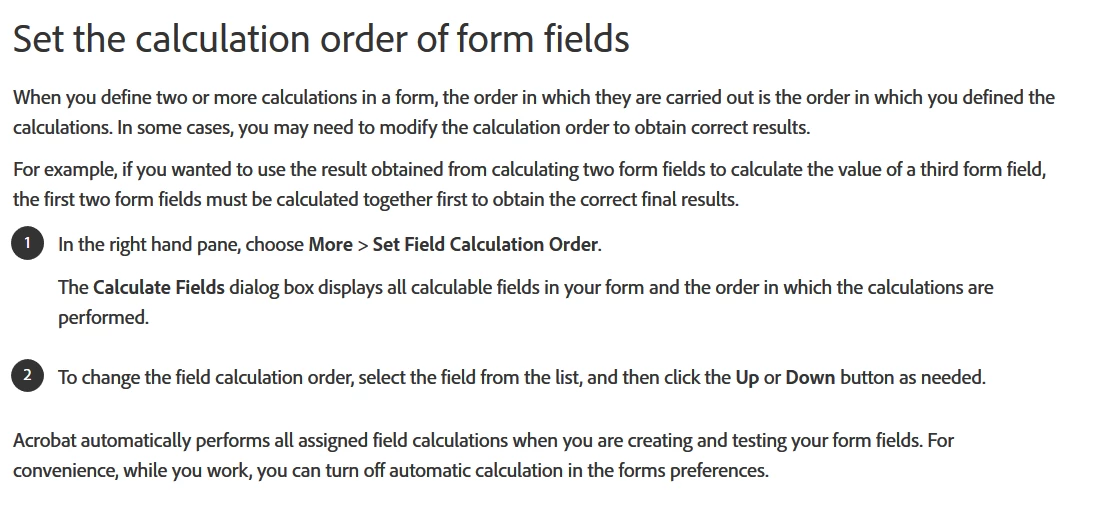

try change field calculation order.
Asim123Correct answer
August 14, 2020
