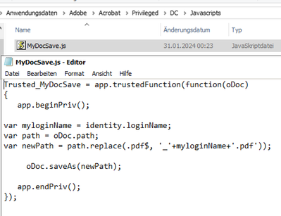

It didn't work but it was recognized, as you got errors about lines of code within it, unless you were running it all from the Console... This error means the JS file is not recognized. So either it's not really a .js file (Notepad will add .txt to files it saves automatically) or it's not placed in the right place, or it contains an error. I recommend you switch to Notepad++ for a much better code editor, for starters.
Jan 30, 2024 Jan 30, 2024
Also, remove "var" from the first line of code. It's a function, not a variable.

Make js file with this function and place it in javascript folder:
var MyDocSave = app.trustedFunction(function(){
app.beginPriv();
var userName = identity.loginName;
var doc = this.documentFileName;
var path = this.path;
var newPath = path.replace(doc, doc.replace(/\.pdf$/,'_'+userName+'.pdf'));
this.saveAs(newPath);
app.endPriv();});
Now you can call function from a console or a field or action...etc
Call a function like this:
MyDocSave(this);

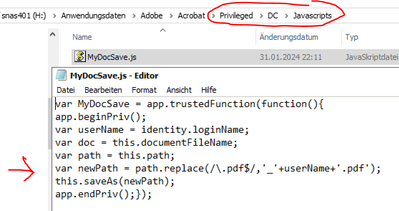

Here is my path and js file, but you see the error.
Jan 31, 2024 Jan 31, 2024
Before the saveAs add this line:
console.println(newPath);
This is the path on 32bit acrobat: C:\Program Files (x86)\Adobe\Acrobat DC\Acrobat\Javascripts
