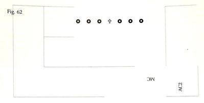

I created a layout of an altar using MS Word using the images and text boxes in the layout tab and it appears like this is Word. When I converted the document to pdf, they lookedd exactly the same as in Word (below).
But when I printed the pdf, I got this:
Sometimes I get this:
When I look at PDF document in my computer, it shows correctly with nothing missing. I made over 70 layouts in this document and three were like this. I fixed the other two by erasing the layouts and doing them again, but this last one (Fig. 62) won't resolve. I've tried erasing the layout and creating it again, or copying the layout of another figure that didn't have any problem but when I print it I get the incorrect images. Fig. 62 appears fine when I look at the document on my laptop in Word and PDF. It prints out fine in Word too. The problem appears only when I print out the document in pdf. Can anyone please help? Thank you.

I have Adobe Acrobat pro on a monthly subscription and use a MacBook laptop. The document was created in Word, and then saved as a PDF document. The mysterious thing is, it is only one page with these two figures that do not print out correctly. All the other figures I created printed out correctly in PDF. I also tried recreating just this page with the same figures in another Word document, saved it in PDF, then printed it out. Surprisingly, it printed out correctly. But when I replaced the problem page in the original file with this new page, saved the entire document in PDF and printed out just this one page, it came out with the same missing details as shown above. This is not making sense anymore. If there was a change somewhere due to postscripting, it should have affected all the figures in the document, not just the figures in one page of the entire document. I'm at a loss.

Check if there are updates to your Acrobat version (click on the "Help" menu), then search the internet with your printer name and model for a print driver update, if there is one, download and install it. If you are still having issues, you can go to your Mac System settings> Printers & Scanners> select and delete the existing printer, then add it back in. You could try printing this page as an image (probably under advanced settings).
